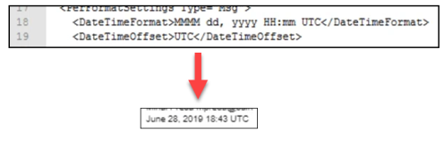

<DateTimeFormat>parameter values in the ConversionEngine.config file are: MMMM dd, yyyy HH:mm UTC - An example of the parameter, its values, and the output is shown below
Example: Default Values

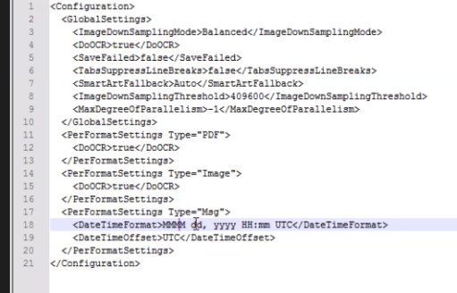

To make changes to your date/time values, including the order of the different values, use the following procedure:
- Open the ConversionEngine.config file for editing from the directory C:\<Smart Previews Import Server install dir>\Bin
- Edit the parameters <DateTimeFormat> and <DateTimeOffset> as you see fit.
