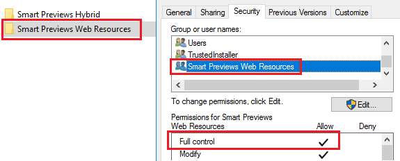

    Service Account
    Your Smart Previews Service account requires full control security permissions to the Web Resources folder.

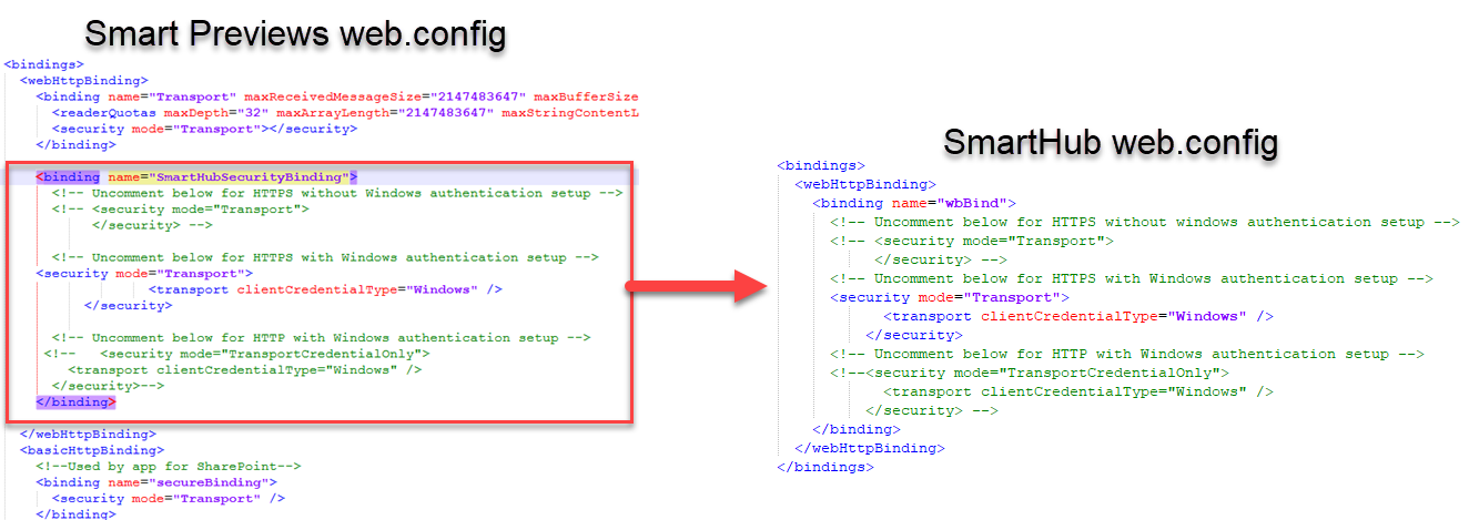

    4. Locate the system.serviceModel\bindings\webHttpBinding section, around line 114.
    5. Change the SmartHubSecurityBinding section to match the security section in your SmartHub web.config file, which is located at the root level of your SmartHub installation directory.
      1. This requires commenting or uncommenting code in the section, as necessary.
      2. In the example below, the security binding in both files is set to "HTTPS with Windows authentication setup."
