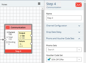

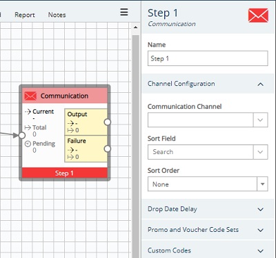

Communication
The communication step allows you to export selected individuals to a communication channel, e.g. Confirmit, Facebook, etc., and send them a communication, e.g. email, targeted ad, etc.
Note: communication steps require a channel and a field list. Contact your system administrator if you need these configured.
Connect a communication step to your campaign.
In the properties pane, select your communication channel, e.g. select your ESP channel if the communication step selects individuals for receiving an email.
Upon selecting a channel, you will be presented with additional fields. Different communication channels have different details, e.g. an FTP output will require you to provide a file name, define field lists, and add an emergency stop limit.
Select a sort field from the dropdown list.
Select a sort order from the dropdown list.
If you need to attach a voucher code, select from a list of your voucher code sets using the dropdown in the properties pane.
Optional: in the properties pane, set a sending timeout to automatically move a lead to the next step if no send or failure response is received.
Note: if using BlueVenn's integrated email communication tool, i.e. the SendGrid channel, you can optimize/localize your communication's delivery.

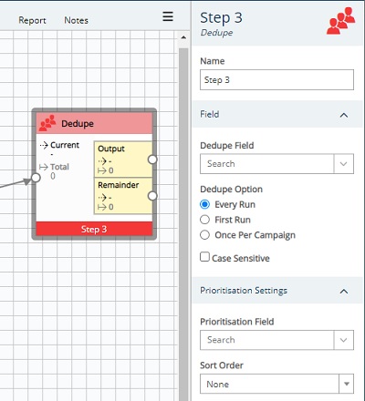

Audience dedupe
Use the dedupe step to select and remove excess records, based on if there are any shared values.
Connect a dedupe step to your campaign.
In the properties pane, select the field to use for deduplication.
Select how often you want to run the deduplication.
Check the case sensitive checkbox if required.
Connect the output node to your next action step.
When you run the campaign, the first record to contain each value will continue. Any further records will be suppressed (placed on the remainder node). How you handle the suppressed records depends on the structure of your campaign.

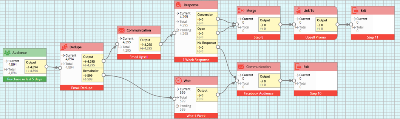

Example: single-run campaign
When you exit your deduped records they are free to re-enter your campaign. This is not an issue for a single-run campaign. For a multi-run campaign where a deduped field is sent an email, exiting the remainder could result in multiple sends.
Example: multi-run campaign with exit
On the first run of a daily campaign where records with a transaction in the past five days are deduped, sent a communication, held on a response node, then moved to a further action depending on the response, the dedupe node identifies 599 duplicate records and exits them from the campaign.
On the second run, the 599 records exited during the first run meet the audience selection criteria and reenter the campaign. The dedupe step now identifies 506 of the returning records as unique and sends another communication, despite having sent a communication to these duplicate records in the first run.
Example: multi-run campaign with wait and manage
On the first run of a daily campaign where records with a transaction in the past five days are deduped, sent a communication, held on a response node, then moved to a further action depending on the response, the dedupe node identifies 599 duplicate records and moves them to a wait step set to seven days.
On the second run, the 599 duplicate records are still on the wait step, preventing them from reentering the campaign. This continues to be the case for subsequent runs as the duration of the wait steps exceeds the five day requirement for audience selection, ensuring that records are no longer eligible for audience selection prior to moving through the campaign.

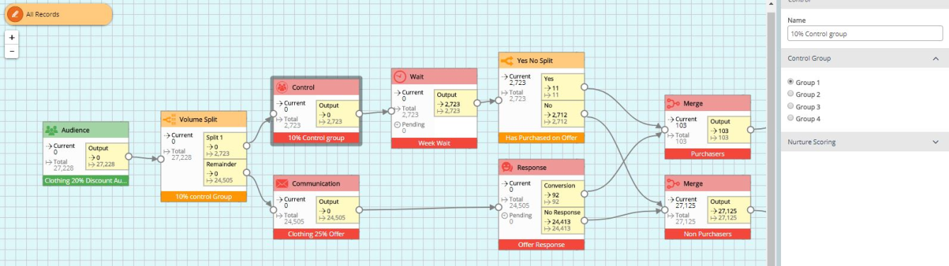

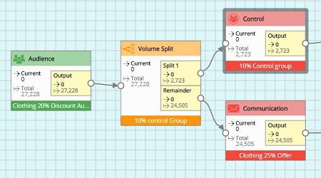

Control step
When running campaigns, you may want to restrict the communication by applying control groups to your campaigns with the intention to measure their engagement. This can become good grounds to measure the effectiveness of a campaign against people who would have purchased your product regardless.
To build and compare a control group:
Split your data (typically 10% for a control group).
Connect a control step to your split data, you can chose one of four control groups, allowing you to run four different control clusters simultaneously on each campaign.
Link your control group back into your campaign data, e.g. by using a yes/no split on if an individual made a transaction and then merging each path with their equivalent campaign response.
Conduct your post-campaign analysis, using your control group selections to view campaign history.

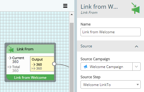

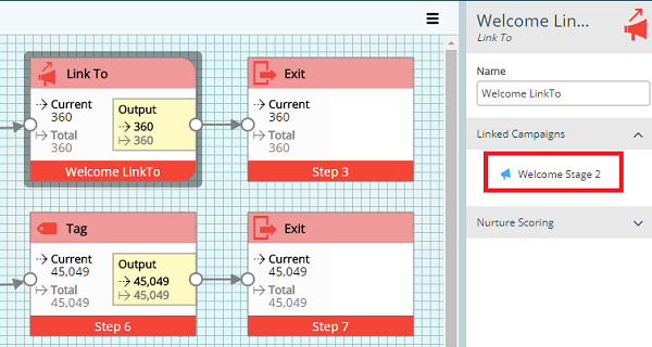

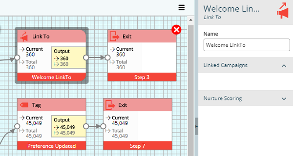

Link to another campaign
With campaign links you can push and pull data across two separate campaigns. This helps to streamline and intertwine multiple campaigns, and is the first stage in developing a full platform customer journey.
Open the campaign that will create your audience, e.g. a campaign that separates individuals that click a link in a promotional email from those who respond to a reminder email.
Add a link to step as an action for the selected individuals.
Open the campaign that will use the linked individuals and insert a link from audience step.
With the audience step selected, use the source campaign and source step dropdowns to select the campaign and step that contains your linked individuals.
Note: you can confirm the link is working by returning to the original link to step. In the properties pane, under linked campaigns, you should see the name of the second campaign.

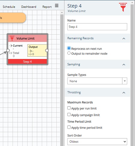

Volume limit (campaign throttling)
The volume limit step allows you to impose a cap on the number of individuals that can pass to the next action, e.g. limit the number of people receiving printed material to the available stock quantity.
Connect a volume limit step to your campaign.
In the properties pane, decide if you wish to have the audience reprocessed on next run or output any remaining individuals to a remainder node.
If you are using sampling, select a sample type.
Choose your method of throttling.
Use an apply per run limit when you want to allow additional individuals through the step during every campaign run, e.g. to drip feed promotion codes.
Use an apply campaign limit when there is a finite amount of allocation for the campaign, e.g. a limited quantity of free gifts for distribution.
Use an apply time period limit to drip feed individuals to the next step e.g. to limit the number of communications being made each hour.
Set a sort order. The sort order defaults to oldest, meaning that the oldest records in the campaign will pass through the step first when re-running the campaign, preventing records getting stuck if the number of individuals entering the step each run exceeds the volume limit.
Note: if outputting to a remainder, a second output step will be made available to move excess records to another branch of the campaign.

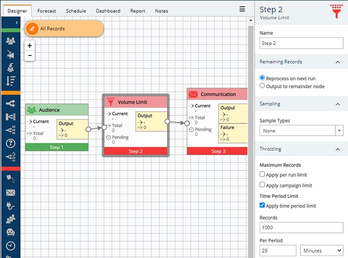

Example: you need to limit a campaign to pass a maximum of 1000 records to a communication step every 30 minutes.
Option 1 - apply a time period limit with a 1000 record limit and a period duration of 29 minutes then schedule your campaign to run every 30 minutes. The time period limit being less than 30 minutes allows for the volume limit step to complete before the next run begins.
Option 2 - Since there are no other steps requiring a more frequent campaign run, e.g. a step with a 20 minute refresh requirement, set an apply per run limit of 1000 records and schedule the campaign to run every 30 minutes.
