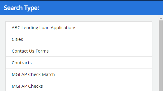

  1. Navigate to the Search Portal.
  2. Select a project from the Search Type list.
    Note: Based on the security settings for the project, you may need to provide your FileBound credentials or an access code to perform search on the selected project.
  3. Specify search criteria in the relevant index field boxes.
  4. Click Search.
