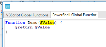

You can specify the variable you are passing into the PowerShell script via the function. In the example below, the data returned from the Connect integration is passed into the PowerShell script via $Value, but you can change the name.

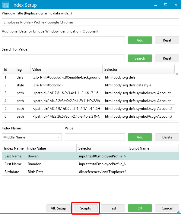

Click Scripts to add global VBScript or PowerShell functions.

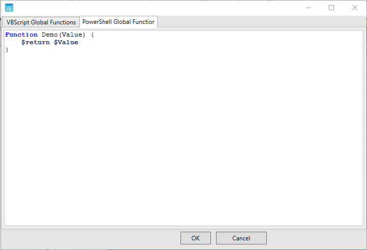

Enter VBScript or PowerShell functions on the specific tabs, then click OK.
