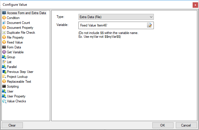

Select an option from the Type list, to specify the type of data that will be returned. The following options are available:
- Form Data (Document): Returns the data associated with the document.
- Extra Data (File): Returns the data associated with the file.

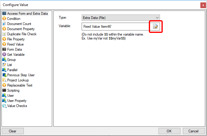

Specify the name of the variable to be accessed in the Variable box or click Configure, to open the Configure Value dialog box and configure a value term. See Stencil value terms for more information.
Note: When entering the variable name, you do not need to include the $$ variables that are normally used when the value is used within a form. - Click OK.
