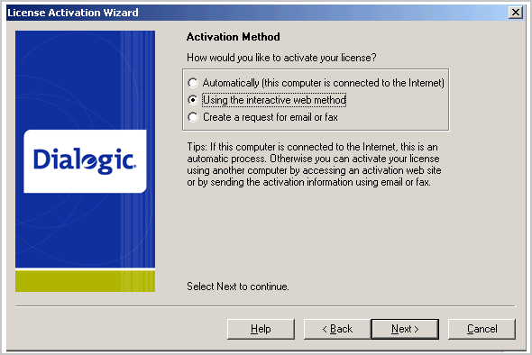

- Click Start >Program Files > Brooktrout License Manager. The BrookTrout License Manager opens.
- In the menu bar click License >Activate License. The License Activation wizard opens and you see the Welcome message.
- Click Next. Select Using the interactive web method.
- Click Next. You get the Node Lock value.

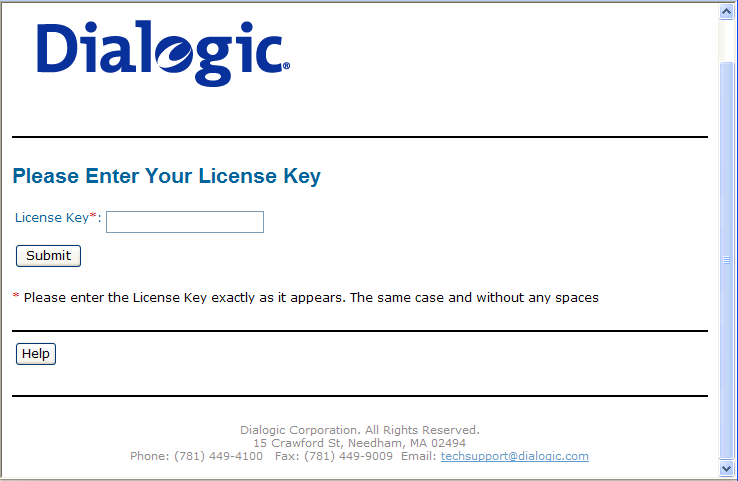

- Open Internet Explorer and go to http://www.dialogic.com/activation.
- In the License Key text box, enter the License key and the Node Lock value of your system.
Note: IMPORTANT! For the license key, contact your software representative.
- Brooktrout sends you the license for your BrookTrout SR140 module.

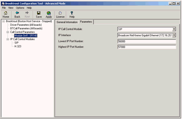

- Click Start > Program Files > BrookTrout Configuration Tool. The Configure IP Stack page opens.
- Select the protocol appropriate to your environment. The BrookTrout Configurations Tool opens.
- Expand Call Control Parameters.
- Select Module0x41:SR140.
- In the right pane, click the Parameters option.
- Verify that the IP Call Control Module value is SIP or H.323 (depending on which protocol is configured for your company).
- Continue to Additional SIP configuration or Additional H.323 configuration. You can configure SIP or H.323, but not both.
