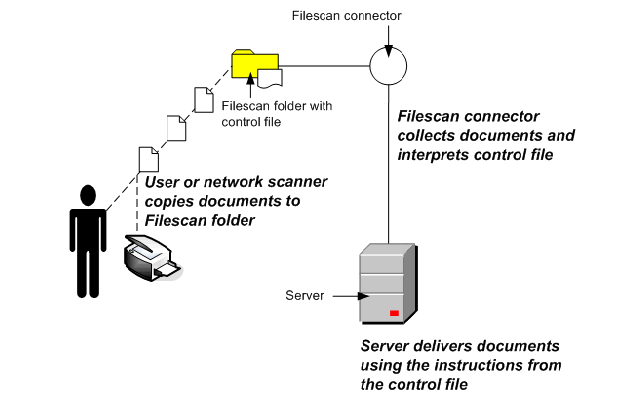

Your company can send documents using the Filescan connector. Outbound documents can be copied to a Filescan folder by individual users or network scanning devices.
By routinely monitoring Filescan folders in the local area network, the Filescan connector instantly detects documents and collects them. As soon as the Filescan connector collects a document from a Filescan folder, the connector interprets the control file—a simple text document that contains delivery instructions for the document—and makes this information available to the server.
