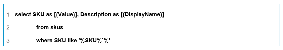

The query must reference the lookup job property (via substitution); for example, %lookupjobpropertyname% and specify the display text and internal value columns by using an "as" clause.
See the Query (SKU job property) example below.
The server expects {Value} and {DisplayName} to be returned from the database when the Lookup function is applied. Other columns returned are ignored.
Note: The example above uses “like” and the percent symbol (%) wildcard character. This is what the server uses to determine substitution. A back tick character (known as a back apostrophe) (`) must be included in the quoted string as shown above. The back tick is used to ignore the percent symbol and not process it as part of a substitution. This allows it to pass through the SQL engine where it is used as the "like" wildcard character.

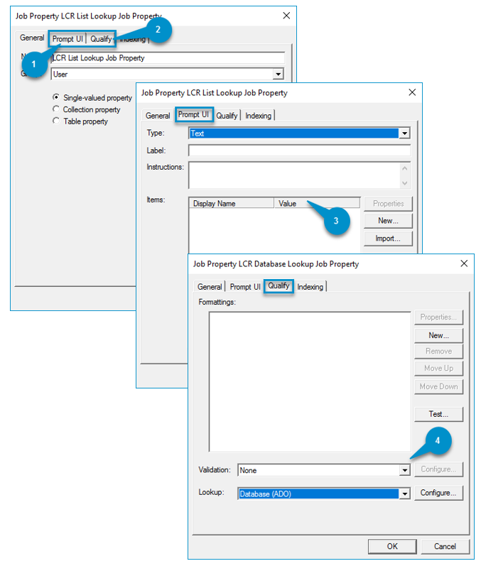

Lookup Job Property at a Glance
Lookup Job Property Legend |
Description |
1. Prompt UI tab |
Use to create and configure a List lookup. |
2. Qualify tab |
Use to create and configure a Database lookup. Note: The Qualify tab is also used to qualify a List lookup. |
3. Prompt UI (list) parameters |
Use to specify list items, display names, values and more. See Configuring a List lookup for more information. |
4. Qualify (database) parameters |
Use to specify, configure, test database parameters and more. See Configuring a Database lookup for more information. |
