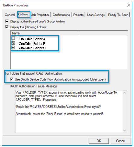

  1. Select the Options tab.
  2. Ensure the appropriate Display options and folders are selected.
  3. Below the For Folders that support OAuth Authorization heading, select the Use OAuth Device Code Flow Authorization check box.
  4. Click OK.
See the Button Properties > Options dialog box example below.
Note: Users will get an OAuth Authorization Failure message at the device if the Use OAuth Device Code Flow Authorization option is not selected.
