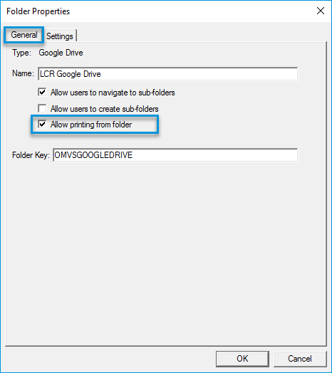

  2. Select Folders on the Server Administrator tree. The folders appear in the Folders details pane.
  3. Select the appropriate folder.
  4. Select the General > Allow printing from folder check box.
See the Folder Properties dialog box example below.
