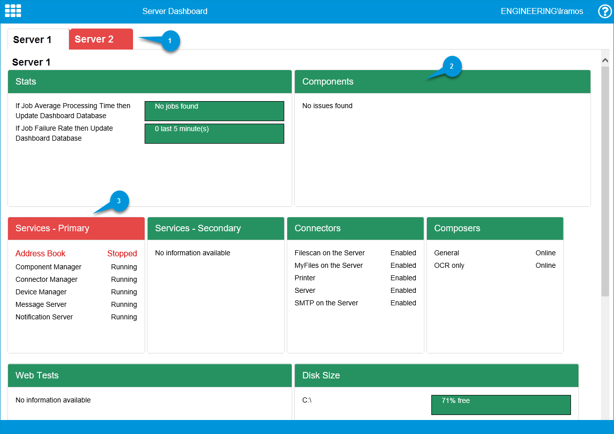

Server Dashboard at a Glance
Server Dashboard Legend
Description
1. Server Dashboard tabs
Use to select and view multiple Server Dashboards if multiple servers are part of your workflow configuration.
Note: The tab and/or border changes to a red color if the server is experiencing any issues.
2. Server Dashboard widgets
Use to view server activity and server-related information.
Note: The information displayed in the widgets is based on the Server Dashboard default or custom test criteria created.
3. Server Dashboard color-coded format
Use the following colors to view server status and determine appropriate actions to resolve issues.
  • Green - server activity is optimal.
  • Yellow - server activity is degraded.
  • Red - server activity is experiencing issues.

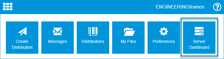

Accessing Server Dashboard
You can access the Server Dashboard by opening the WebApps application.
To access the Server Dashboard
  1. Open your browser.
  2. Type or paste your specific WebApps URL in the browser’s address bar.
  3. Press Enter. The WebApps application appears.
  4. Select the Server Dashboard tile. The Server Dashboard appears.
See the WebApps > Server Dashboard tile example below.
