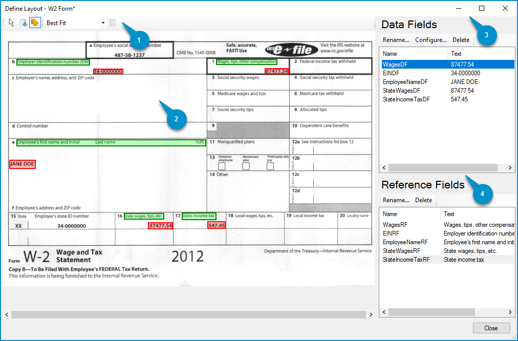

1. Zonal Form Definitions Project (ZFDP) tool bar
Use the ZFDP tool bar to: (from left to right)
  • Pointer  – point, move, and resize data and reference field boxes.
  • Add Data Field – draw a box and define data fields.
  • Add Reference Field – draw a box and define reference fields.
  • Best Fit (Zoom) drop-down list box – choose a Zoom level to view the form.
  • Best Fit – reset the Zoom level to the Best Fit default.
2. Preview pane
Use the Preview pane to:
  • View and define data and reference fields in Define Layout.
  • View and train forms in Train Layout.
  • View and test forms in Test Layout.
3. Data Fields pane
Use the Data Fields pane to:
  • View data field definitions.
  • Rename data fields.
  • Configure data fields to be a specific format; for example, date. Text is the default.
  • Delete data fields.
Note: Form Definition Users must verify that data and reference field definitions are clear, intact, and not truncated for best form processing results.
4. Reference Fields pane
Use the Reference Fields pane to:
  • View reference field definitions.
  • Rename reference fields.
  • Delete reference fields.
