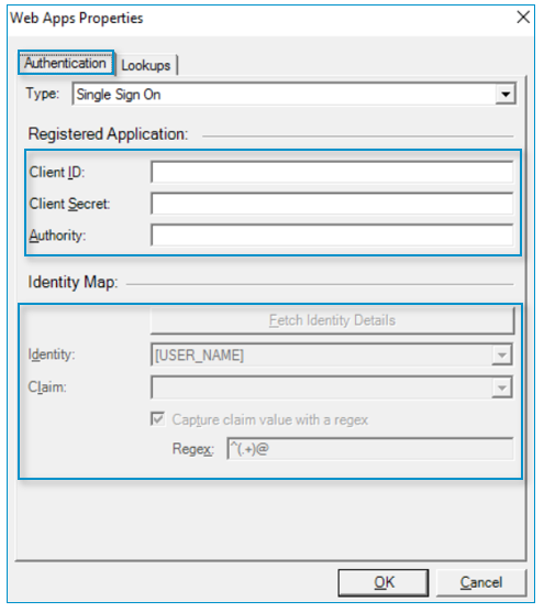

  4. Ensure the Authentication tab is selected.
See the HP CR Client Properties > Authentication dialog box example below.
  1. Select Single Sign-On on the Type drop-down list.
  2. Go to the Registered Application section and paste the Application (client) and Secret IDs from Azure Active Directory in the appropriate boxes.
  3. Type or paste the Identity Provider Authority URL (Directory (tenant) ID) from Azure Active Directory in the Authority box in the following format: https://login.microsoftonline.com/{TenantID}. The Fetch Identity Details button becomes active.
Note: This IDP Authority URL and format are  specific to Azure Active Directory and will be different for other Identity Providers.
  1. Click Fetch Identity Details and log into your configured Identity provider. The Identity Map controls become active with the appropriate defaults selected; for example, upn (User Principal Name). Other options are available and can be selected based on your unique configuration.
  2. Click OK.
