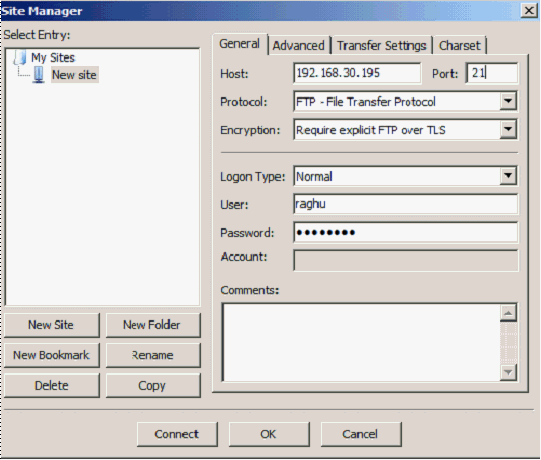

Testing the FTPS connection
To test the FTPS connection
  1. Install FileZilla(3.5.3).
  2. Launch FileZilla.
  3. Navigate to File > Site manager > New Site.
  4. Provide the details for the respective fields and click Connect.
FTPS site will be connected to the specified path.
