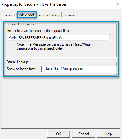

  9. Specify a Secure Print folder to scan. This is the folder you set up in Brooksnet Remote Print Manager (RPM).
See the Secure Print on the Server Properties  dialog box > Advanced tab example below.

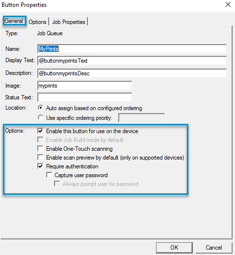

  10. Click MyPrints and select the Properties button. The Button Properties dialog box appears.
  11. Select the General tab, ensure both Enable this button for use on the device and Require authentication are selected.
See the Device Group > Button Properties  dialog box > General tab example below.

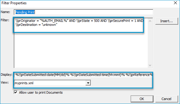

  1. Select the Options tab.
  2. Select Pending Print and the Properties button.
  3. Ensure the Pending Print Filter, Display and View defaults appear in the appropriate boxes.
See the Filter Properties dialog box example below.
  1. Click OK on the Filter Properties dialog box.
