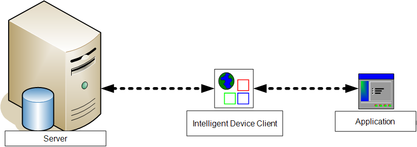

The
Intelligent Device Client facilitates communication between the server and other applications.
Note: Version 2.3 and all later versions install the Intelligent Device client by default. No separate installation is necessary. You must configure the client and test it using instructions in this topic.
Note: If necessary, you can install the client on a remote system.
The Intelligent Device Client helps the following client applications communicate with the server.
