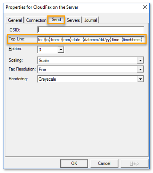

Setting up the CloudFax connector top line variables
You can set up the CloudFax connector by using Server Administrator > Connectors > CloudFax Properties.
To set up the CloudFax connector top line variables
  1. Right-click the CloudFax connector in the Details pane. The Properties shortcut menu appears.
  2. Select Properties. The CloudFax Properties dialog box appears.
  3. Select the Send tab.
See the CloudFax Properties dialog box example below.
  1. Specify the CSID (Calling Station ID) in the CSID box (optional).
Note: The Calling Station ID is used for identification purposes by your InterFax service account. Your InterFax service account includes a default Calling Station ID. The value you specify in the CSID box will override the default CSID used by the InterFax service account.
  1. Specify the variables in the Top Line box.
Example: to: {to} from: {from} date: {datemm/dd/yy} time: {timehhmm} totalpages: {totalpages}
Note: You can specify the labels and variables as shown in the example above or just the variables in the Top Line box.
