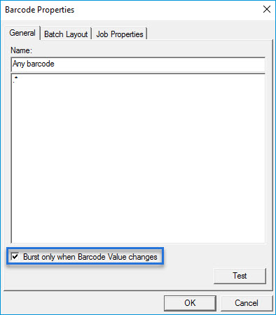

More Bursting connector configurations
You can configure the Bursting connector to break up document batches only when the barcode value changes.
To configure the Bursting connector
  1. Select the Bursting connector in the Connectors details pane. The Bursting connector Properties dialog box appears.
  2. Select the Configuration tab.
  3. Select Any barcode .* in the Name and Regular Expression table. The Barcode Properties dialog box appears.
See the Barcode Properties dialog box example below.
  1. Select the Burst only when Barcode Value changes check box.
  2. Click OK.
