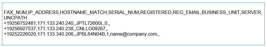

See the Notepad example below.
Third entry after the header
The following parameters are specified in the third entry in the Notepad example above.
- Fax Number
- Device IP Address
- Host Name – the double commas (,,) indicate that the parameter is blank and was omitted.
- Device Serial Number
- Device is registered – The one (1) value indicates that the device is registered.
- Registered Email – The email address for regulatory notification.
Note: The double commas (,,) at the end of the third entry indicate that the remaining parameters are blank and were omitted.

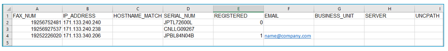

See the Excel example below.
This example illustrates how the file will appear when you open a Notepad CSV file in Excel.

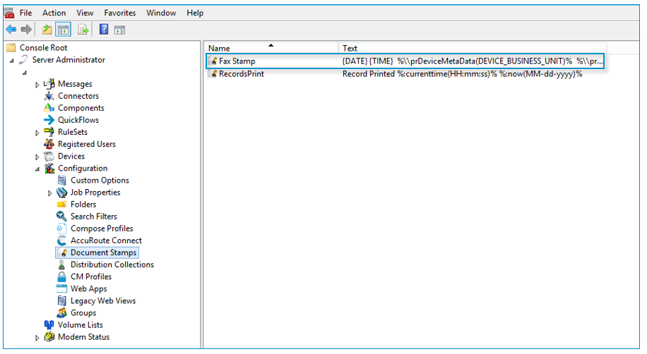

Document Stamp
Document Stamp information can also be included with your DTT Import by specifying the name of your document stamp in quotes; for example, “Fax Stamp”.
Note: Use the quotes (“ “) only if your document stamp name contains spaces.
You can find the document stamp name by using Server Administrator > Configuration.
To find the document stamp name
- Start the Server Administrator.
- Expand Configuration.
- Select Document Stamps. The Document Stamps Details pane appears.
- Make a note of the appropriate document stamp name.
See the Document Stamps example below.

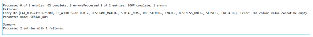

You can view any errors related to a DTT Import at the Command Prompt or in a log.
Tip: Use a log to capture the DTT Import errors if you have a large CSV file.
See the DTT Import with errors example below.
In the example above, the serial number is required and cannot be left blank.

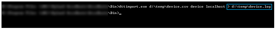

Capturing DTT Import errors
You can capture DTT Import errors by specifying a location and log name.
To capture the errors
- Use the Greater than (>) symbol at the end of your parameters.
- Specify the location and name of the Log file.
- Press Enter.
Go to the appropriate location, open, and view the Log file.
See the DTT Import and log example below.

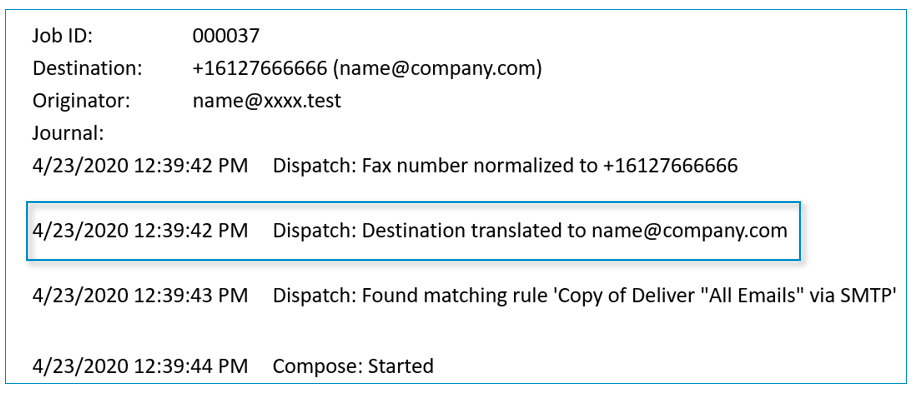

You can view the translations as messages are successfully routed to their new destinations by using the Journal in the History folder.
To view the Journal
- Expand Messages.
- Select History. The History folder opens.
- Select the Job ID you want to view. The Recipient Properties dialog box appears.
- Select the Journal tab. The Journal entries appear.
- Select the Dispatch Journal entry to view the translation.
- Click Close on the Journal Entries Properties dialog box.
- Click Close on the Recipient Properties dialog box.
See the Journal example below.
