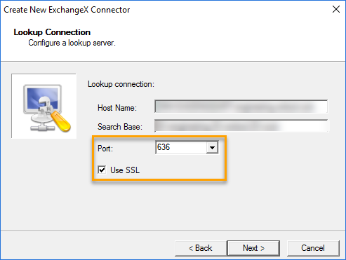

See the Lookup Connection dialog box example below.

  1. Use the default port setting or select a different port from the drop-down list.
  2. Continue with Enabling SSL.
Enabling SSL
  1. Select the Use SSL check box.
