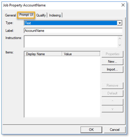

To set up the data field job properties
Start the Server Administrator, if necessary.
Expand Configuration.
Right-click User. The Properties shortcut menu appears.
Select New > Job Property. The Job Property dialog box appears.
Type a name in the Name box, for example, AccountName.
Select the Prompt UI tab.
Select Text on the Type drop-down list, if necessary.
Select the Indexing tab and select Active Volume List.
Select OK.
Repeat Steps 3 through 9 for additional data field job properties, for example, InvoiceNumber and TotalDue.

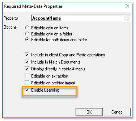

To add the data field job properties and enable Learned Automation
Select Queues. The Queues Details pane appears.
Select the appropriate queue. The Properties for Queue dialog box appears.
Select the Properties tab.
Select the Add button. The Required Metadata Properties dialog box appears.
Select the property, for example, AccountName on the Property drop-down list.
Select OK.
Ensure the Editable for both items and folder option is selected.
Select Enable Learning for this type of job property.
See the Required Metadata Properties > AccountName dialog box example below.
Select OK.
Repeat Steps 5 through 9 for additional job properties, for example, InvoiceNumber and TotalDue.
Select OK on the Properties for Queue dialog box.
