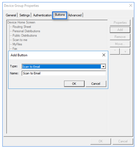

To set up Scan to Email
  2. Expand Devices on the Server Administrator tree.
  3. Right-click the appropriate device group. The Properties shortcut menu appears.
  4. Select Properties. The Device Group Properties dialog box appears.
  5. Select the Buttons tab.
  6. Select Add. The Add Button dialog box appears.
See the Device Group Properties > Buttons dialog box example below.
  1. Select OK. The Scan to Email button appears on the Device Home Screen tree.

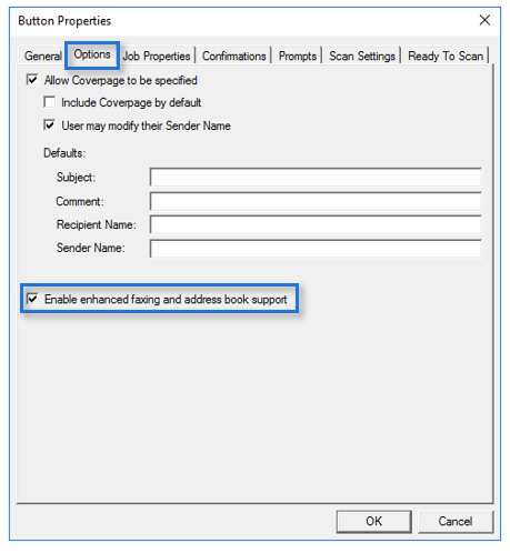

Enhanced Fax
The Fax button can be enhanced to work with the Scan to Email functionality.
To enable enhanced fax
  6. Select Fax on the Device Home Screen tree.
  7. Select Properties.
See the Fax Button Properties dialog box example below.
  1. Select Enable enhanced faxing and address book support.
  2. Select OK on the Button Properties dialog box.
  3. Select OK on the Device Group Properties dialog box.

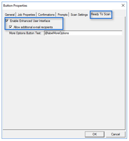

Enhanced Routing Sheet
The Routing Sheet button can be enhanced to work with the Scan to Email functionality.
To enable enhanced routing sheet
  6. Select Routing Sheet on the Device Home Screen tree.
  8. Select the Ready to Scan tab on the Button Properties dialog box.
  1. Select Enable Enhanced User Interface and Allow additional email recipients.
Note: The Ready to Scan tab can be used to enable Scan to Email functionality with other buttons that require scanning on your device. The Ready to Scan steps listed above can also be used for other Scan-related button setup.
