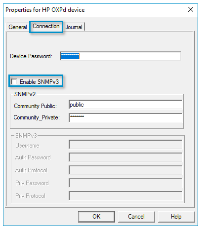

To enable SNMP v3
For HP OXPd devices
  2. Expand Devices on the Server Administrator tree.
  3. Select the appropriate device group.
  4. Select the appropriate device in the Devices details pane. The Properties dialog box appears.
  5. Select the Connection tab.
See the Properties for HP OXPd device dialog box example below.
  1. Select the Enable SNMP v3 check box. The SNMP v3 area becomes active.
  2. Specify a username in the Username box.
You can specify the following protocols.
  • Authentication and Privacy
  • Authentication only
  1. Specify an authentication password in the Auth Password box.
  2. Specify the authentication protocol type in the Auth Protocol box
  3. Specify the privacy password in the Priv Password box.
  4. Specify the privacy protocol in the Priv Protocol box.
