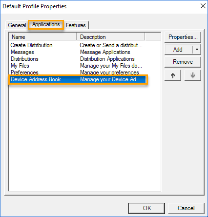

  4. Select the Default profile or a different profile, if necessary. The Profile Properties dialog box appears.
  5. Select the Applications tab.
See the Profile Properties > Applications dialog box example below.
  1. Select the Add button. The Applications shortcut menu appears.
  2. Select Administration > Device Address Book.
  3. Select OK on the Device Address Book Application Properties dialog box.
  4. Select OK on the Profile Properties dialog box.

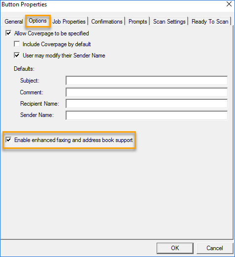

  8. Select the Options tab.
See the Fax Button Properties dialog box example below.
  1. Select the Enable enhanced faxing and address book support check box.
  2. Click OK on the Button Properties dialog box.
  3. Click OK on the Device Group Properties dialog box.

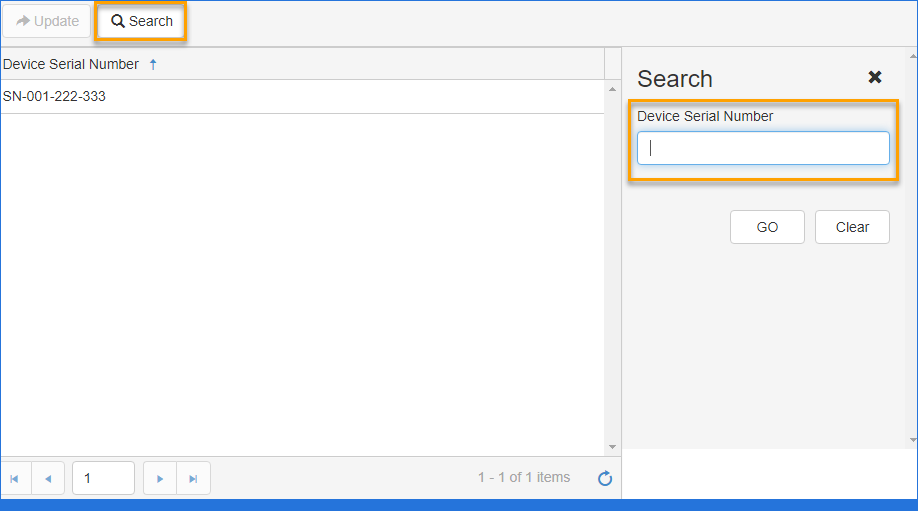

2. Select Device Address Book. Device serial numbers appear in a list.
3. Select Search to find the device serial number to transfer the address book from, if necessary.
See the Search dialog box example below.
Tip: Use the Sort arrow in the column header to sort the device serial numbers in ascending or descending order.

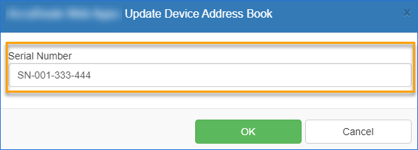

  2. Select Update. The Update Device Address Book dialog box appears.
See the Update Device Address book dialog box example below.
  1. Specify the new device serial number in the Serial Number box.
  2. Click OK.
