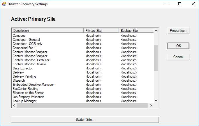

If Disaster Recovery is currently set up via the Server Administrator, open the Disaster Recovery settings in the Server Administrator and select OK to save the settings without making any changes. This ensures that each Disaster Recovery component is given a unique name which is required for scripting.
See the Server Administrator > Disaster Recovery Settings dialog box example below.

Note: The component names are the same as those shown in the Server Administrator > Disaster Recovery Settings dialog box.
