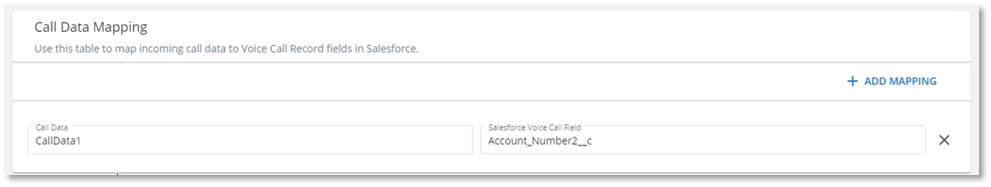

  1. On the Call Data Mapping page in the InGenius Admin App, select "+ Add Mapping". A blank mapping is added in the area below.
  2. Name the Call Data field CallData1. This mapping corresponds to the data sent through the IVR action, which is then parsed based on whitespace characters. Each subsequent mapping should be named CallData2, CallData3, etc. and will correspond to a portion of this data separated by whitespace.
    Note: (e.g., with an IVR action containing the data "Test 123", CallData1 will map to "Test", CallData2 will map to "123".)
  3. Name the Salesforce Voice Call Field the name of the corresponding custom field you created previously.
  4. Select Publish Changes to save the changes to the page.
