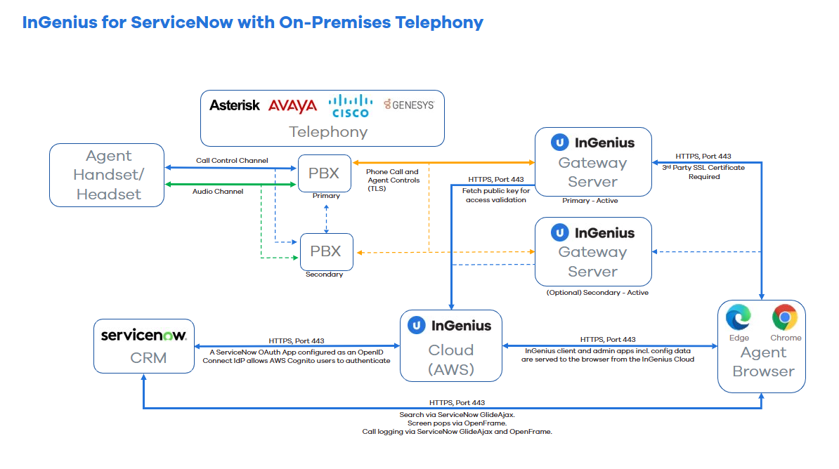

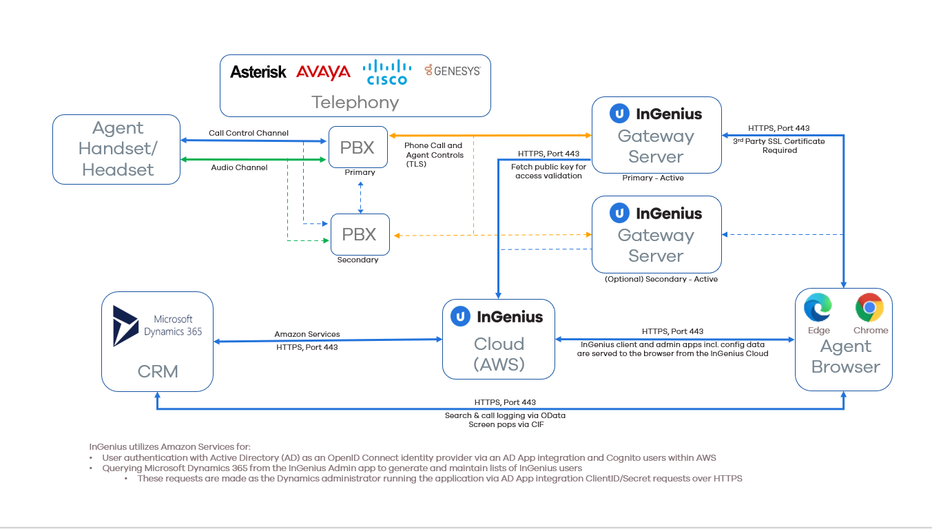

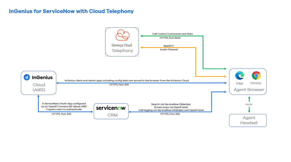

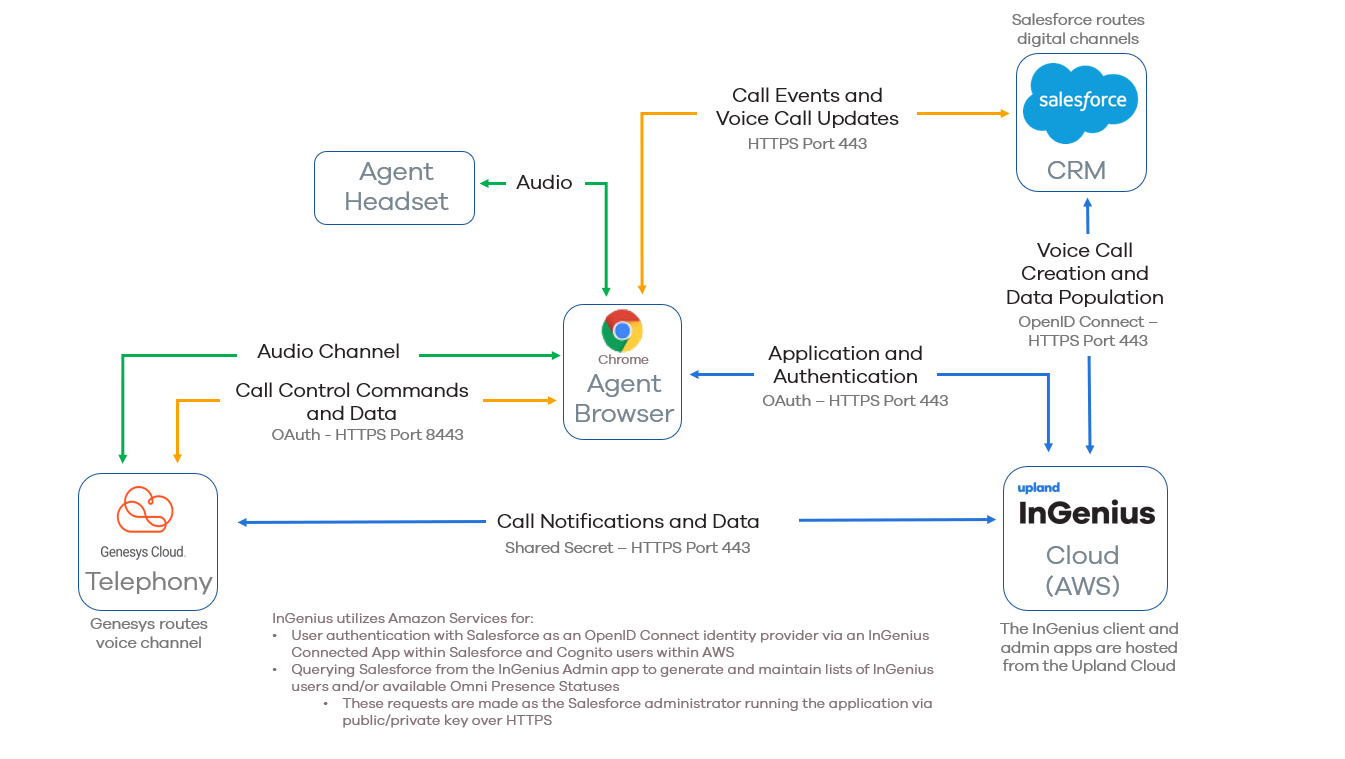

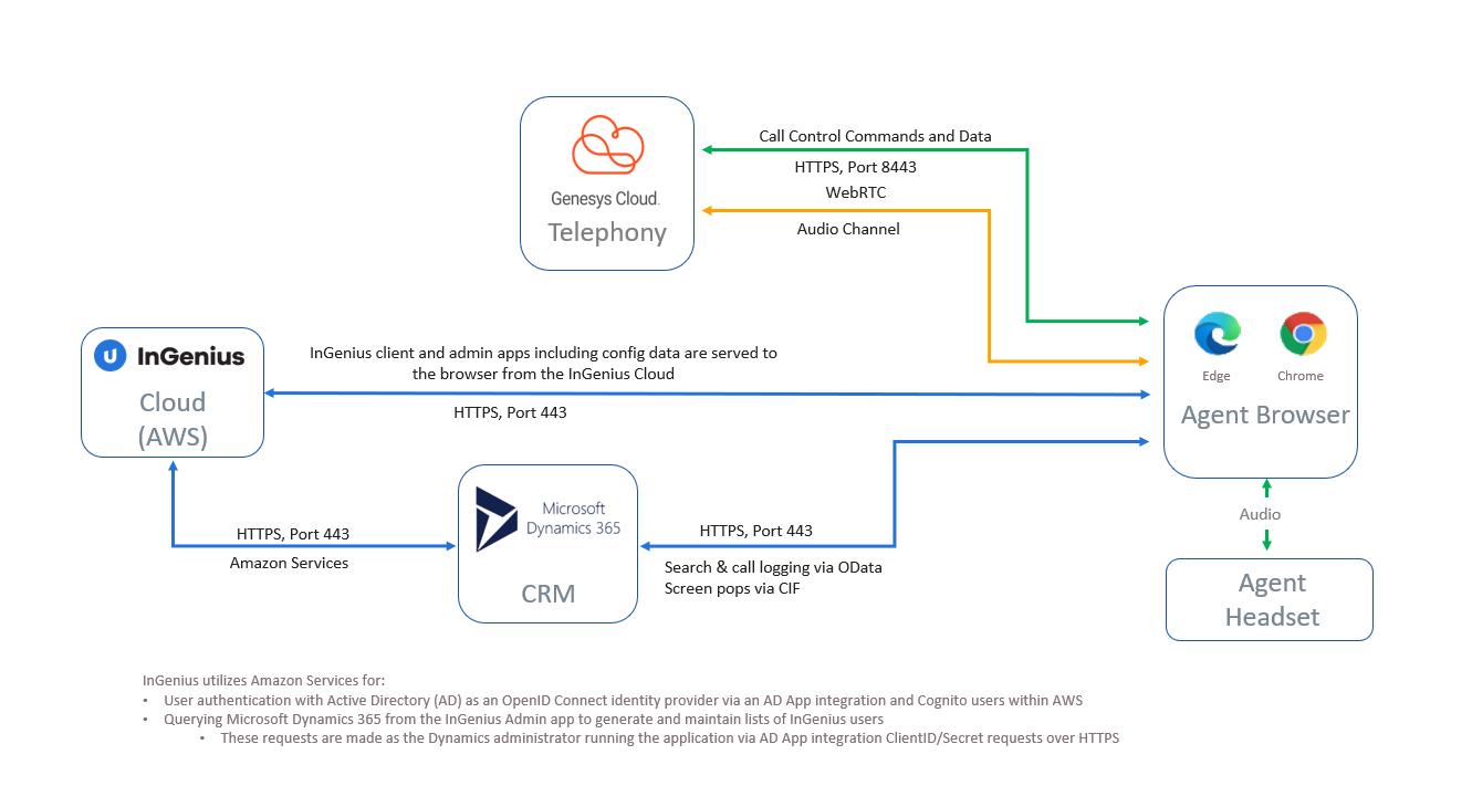

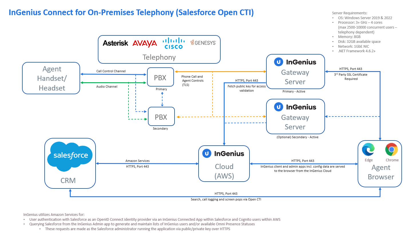

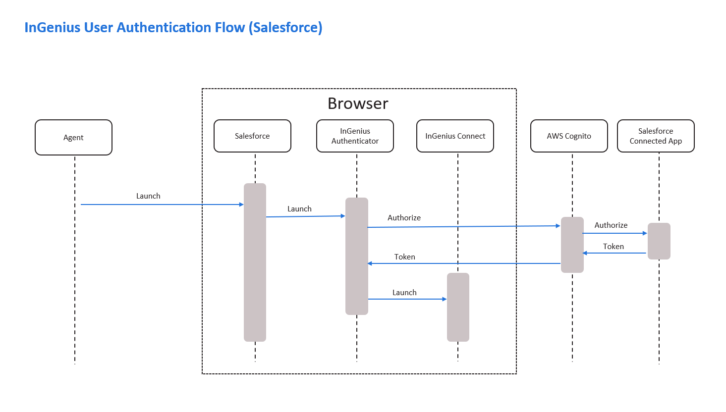

Architecture
InGenius easily accommodates the unique telephony and CRM workflow requirements of your organization.

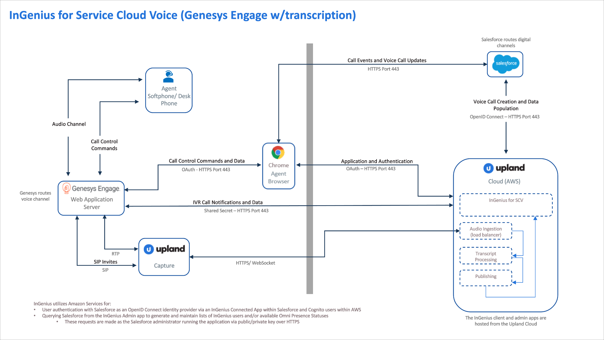

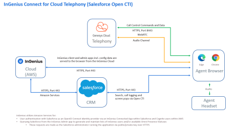

The diagram below describes the network architecture between InGenius and Genesys EngageGenesys Cloud.
