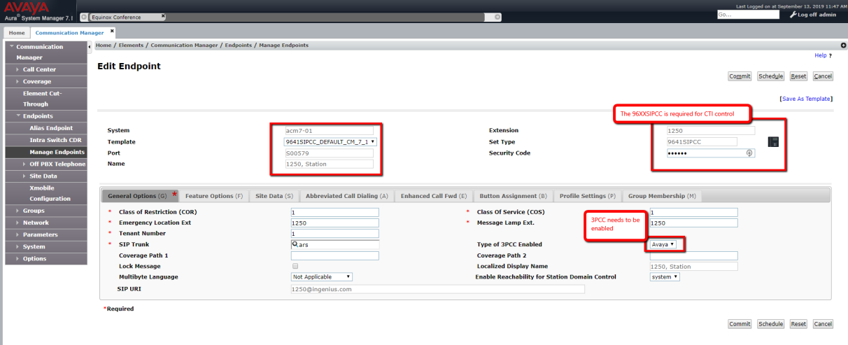

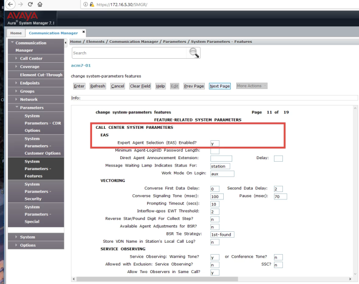

Avaya SIP Configuration
The following settings must be configured in Avaya Communication Manager if using Avaya SIP phones:
- Enable Expert Agent Selection (EAS) as shown in the image below.
- Enable CTI for the SIP endpoint. Use a 96xxSIPCC template and enable the 3PCC, as shown in the image below.

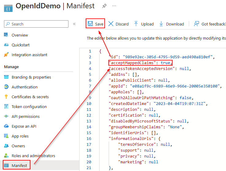

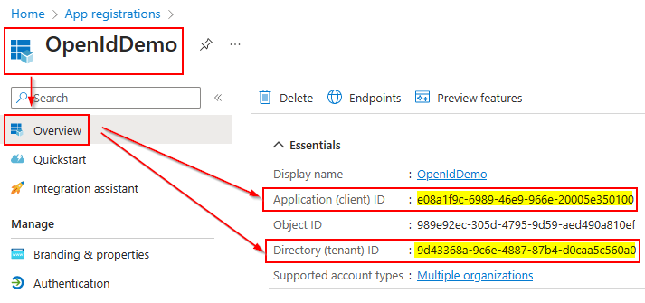

Microsoft Dynamics 365 must first be pre-configured with Azure AD (Azure Active Directory) to integrate properly with InGenius Connect and allow for a secure authentication process for your users.
Create and Setup an Open ID Provider App Registration
An application must first be created in Azure AD that your D365 users will use to send a request to login to InGenius.
Create an Open ID Provider App Registration
To create and configure this application, follow the instructions below:
Login to your Microsoft D365 instance.
Access the Admin app from the 9 dots on the top-right corner.
From Admin, select ... Show All | Admin Centers | Microsoft Entra
In the top search bar, search for and select 'App Registrations', and then click + New registration from the top ribbon.
Input the following information into the registration window:
Name: Enter an appropriate name.
Supported account types: Select 'Accounts in any organizational directory (Any Azure AD Directory - Multitenant)'

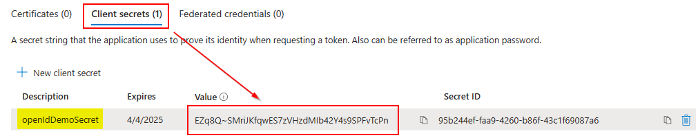

Create Secret for your App Registration
From the top search bar, search for and select 'App Registrations' and select your newly registered app.
Under Manage | Certificates & secrets, click the '+ New client secret' button below the 'Client secrets' section.
From the right panel, fill in the information for the client secret as follows:
Description: Enter an appropriate description.
Expires: Select the preferred expiry duration for this secret.
Note: It is recommended, out of convenience of not having to recreate the client secret, to select the longest duration '(730 days)'.
Click Add
In the listing for your newly created client secret, record the line under the Value column. This string will be used in the authentication process.
Note: Make sure to record the string under the Value column, and not the Secret ID.

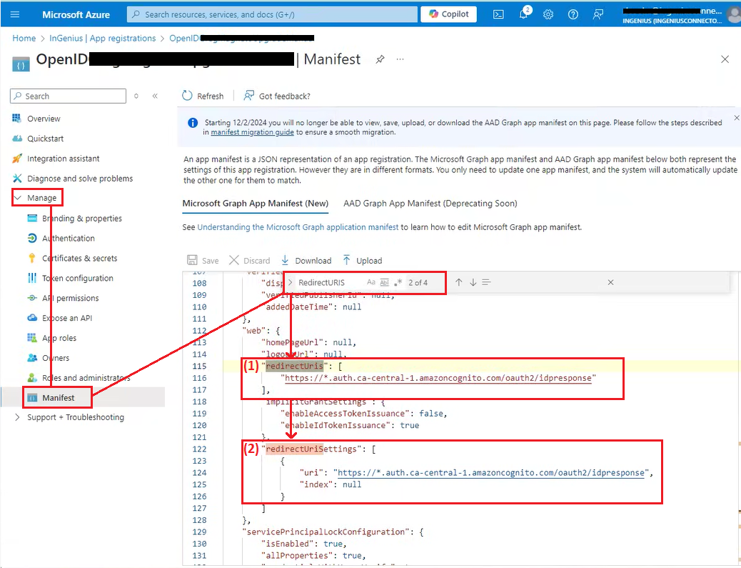

Update Application Manifest
Navigate to App Registrations through the top menu search bar and then select your newly registered app.
Under the Manage section, select Manifest.
In the XML text editor, update the app manifest to accept mapped claims as follows:
Set the value of 'acceptMappedClaims' to be true by changing the line to "acceptMappedClaims": true
Copy"acceptMappedClaims": true
In the JSON editor that opens, use CNTRL+F to search the page for "redirectURIs".
Between the square brackets for "redirectUris", add the following object with your wild card modified redirect URI, making sure to replace <region> with your deployed region:
Copy{
"url": "https://*.auth.<region>.amazoncognito.com/oauth2/idpresponse",
Between the square brackets for "redirectUriSettings", add the following object with your wild card modified redirect URI, making sure to replace <region> with your deployed region:
Copy{
"index": null
Ensure your resulting manifest matches the image above, then click Save.

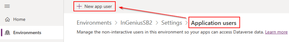

Add Open ID App to Users of D365 Instance
Login to your D365 environment and select the App Launcher (9 dots in the top-right corner) and select the Admin app.
In the left-hand panel of the Admin app, click Show All, and then under the 'Admin Centers' section select All admin centers.
From the 'All admin centers' page, select Dynamics 365 Apps, then from the 'Power Platform admin center' page select Environments and select the specific environment for your D365 instance.
In the configuration page for your environment, click the Settings button in the top menu.
From the Settings page, click the 'Users + permissions' drop down and then select Application Users.
Click the '+ New app user' button in the top menu bar and fill in the information as follows:
In the App section, select the app you registered in the previous steps.
In the Security Roles section, select Basic User.
Click the Create button to complete.

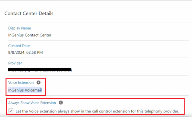

Configure Personal Voicemail
In order for agents to view and receive personal voicemail, a couple of settings must be configured under your Contact Center settings. Follow the instructions below:
Log into your Salesforce Org
Navigate to Feature Settings | Voice | Partner Telephony Contact Centers
Under the 'Voice Extension' dropdown, select InGenius Voicemail.
Check the 'Always Show Voice Extension' box.
Click Save.

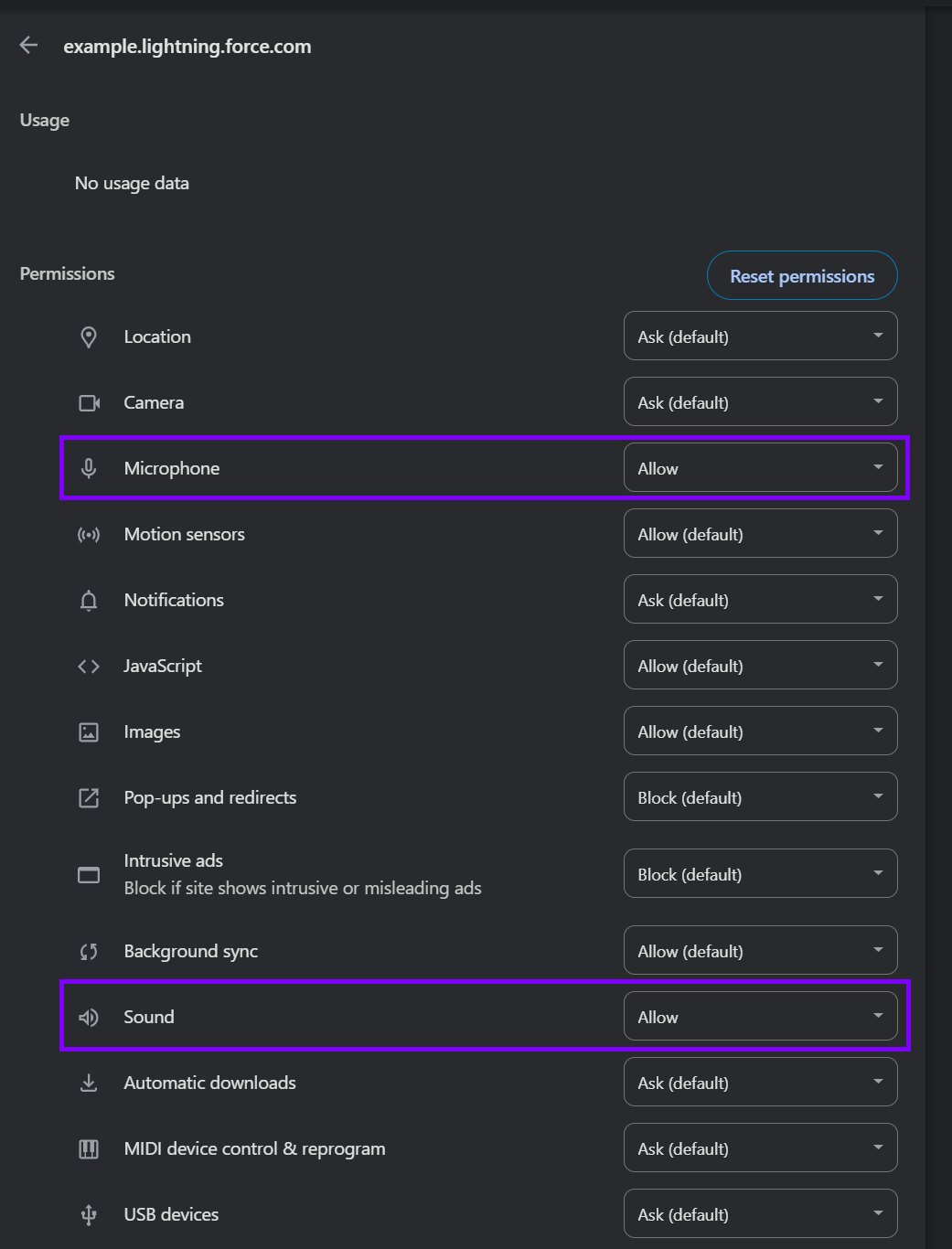

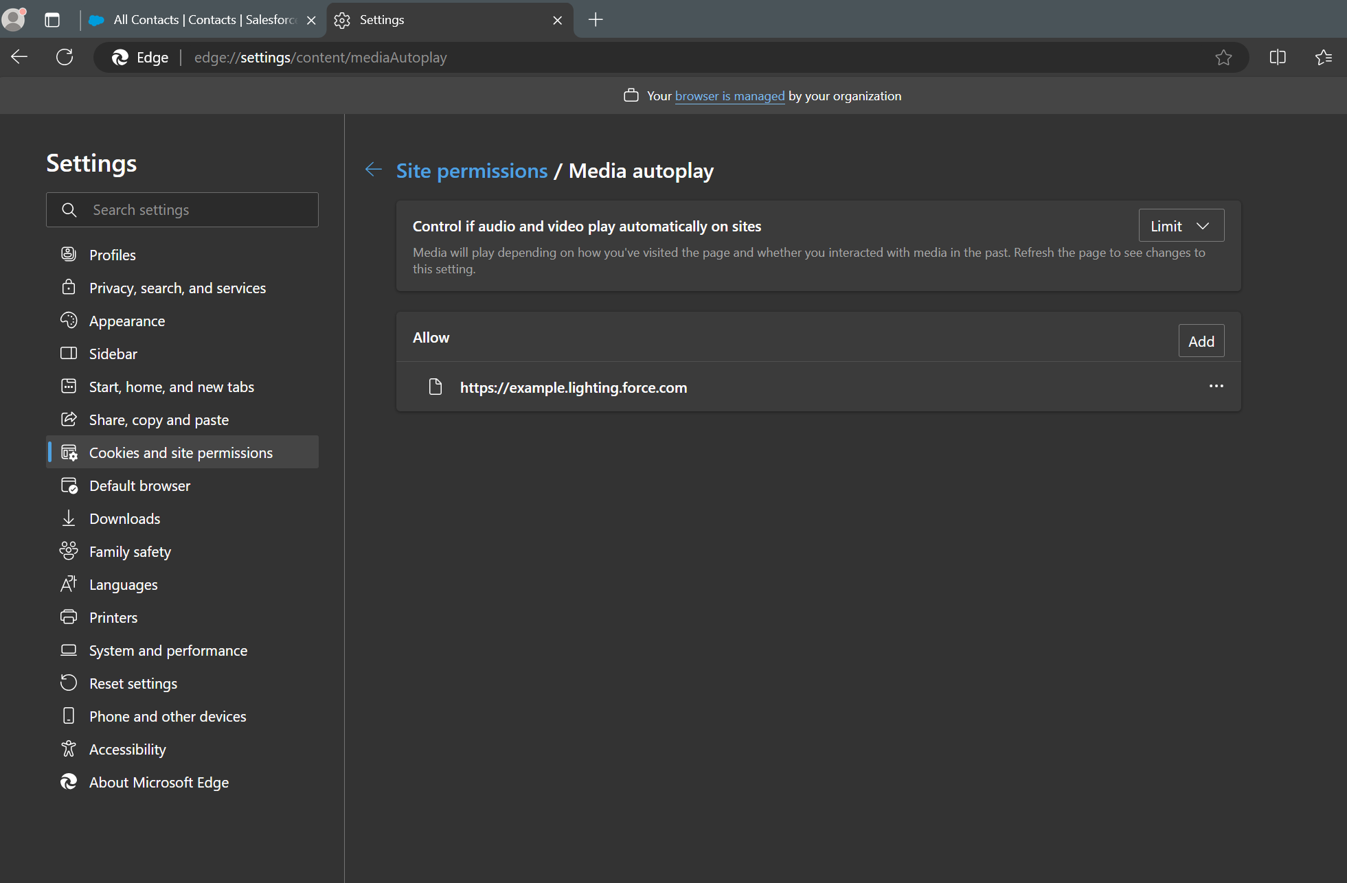

Enable Browser Audio Permissions
To ensure InGenius notifications and ringtones are uninterrupted, it is recommended that you add the Salesforce site to your browser's audio allowlist. Follow the instructions below:
For Chrome browsers:
Login to your Salesforce Org.
Click the 'View site information' button to the left of the URL on the address bar, and then click 'Site settings'.
Ensure the Microphone and Sound settings are changed to Allow.
For Edge browsers:

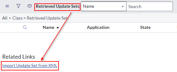

Click the All tab in the navigation menu, and search for 'Retrieved Update Sets'
Click the Import Update Set from XML button in the bottom-left corner of the window.
Click the Choose File button and select the InGenius XML update set you have been provided, then click Upload.
Find the newly uploaded update set in the Retrieved Update Set screen and select it.
Click on the Preview Update Set button to confirm the file has been uploaded successfully, then click Close.
Click on the Commit Update Set button and then click Close.

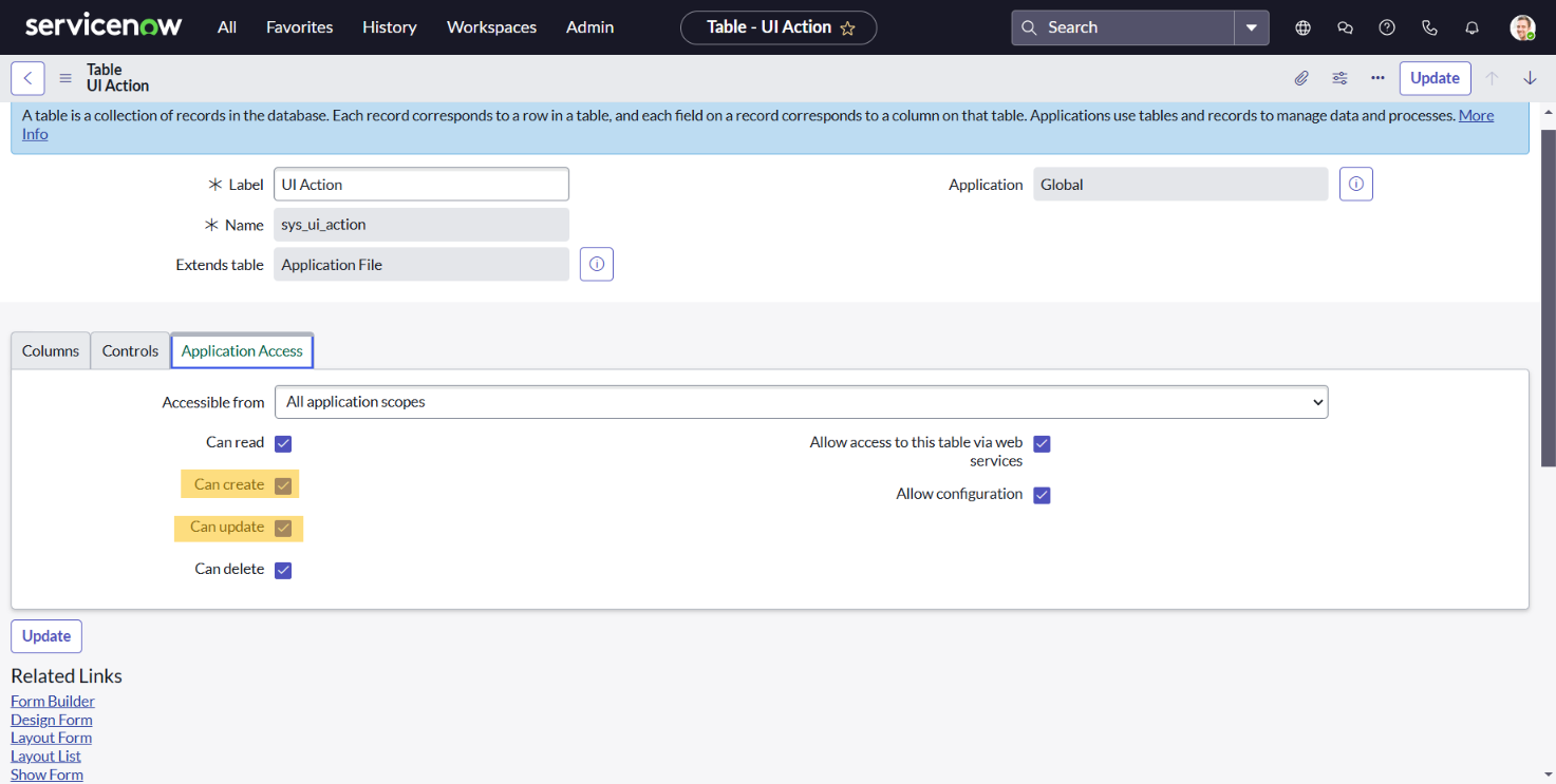

Update UI Action Table
In order to allow UI elements in ServiceNow to be modified by InGenius, you must grant application access through the following:
Login to your ServiceNow instance.
Navigate to All | Tables | sys_ui_action | Application Access
Under the Application Access tab, ensure that the 'Can create' and 'Can update' boxes are checked.
Select Update.

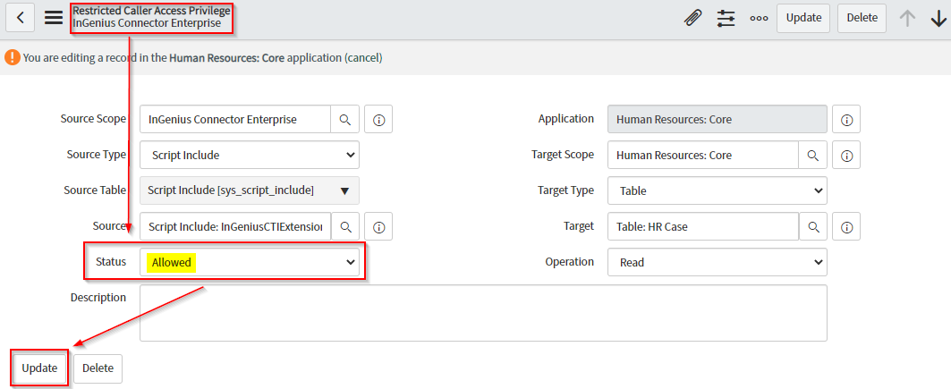

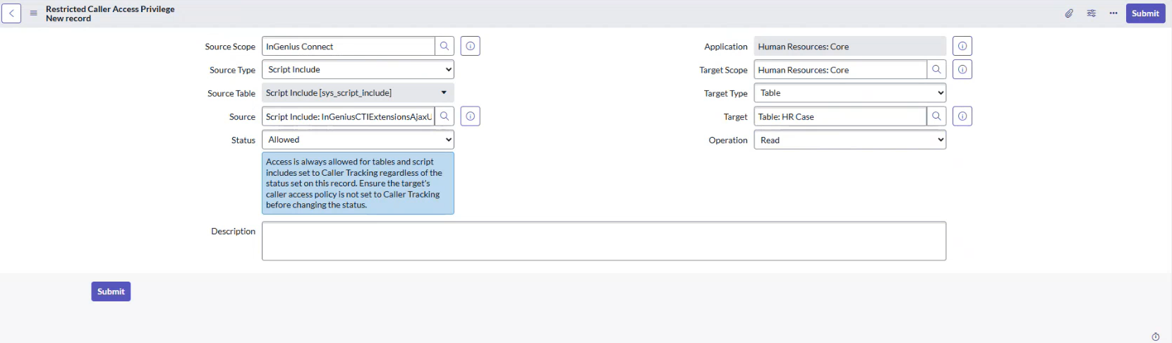

Create Restricted Caller Access Privilege for Table HR Case
Before saving a call log for a Human Resource (HR) Case entity as the related record, restricted caller access privileges must be created and pre-configured to avoid an error in reading that request. Follow the instructions below:

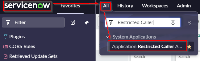

Navigate to All | System Applications | search for 'Application Restricted Caller Access'
From the menu, in the top right corner of the page, click the 'New' button.
Note: Ensure to set your application scope from the top right menu to 'Human Resources: Core', or you will not be able to configure the new record properly.
Create the new record as follows:
Source Scope: InGenius Connect
Source Type: Script Include
Source: 'Script Include: InGeniusCTEExtensionsAjaxUtility'
Status: Allowed
Application: Human Resources: Core
Target Scope: Human Resources: Core
Target Type: Table
Target: Table: HR Case
Operation: Read
Click Submit.

Click the Here link located in the top ribbon to edit this entity.
Modify the Status from Requested to Allowed, and then click the Update button to save your changes.
