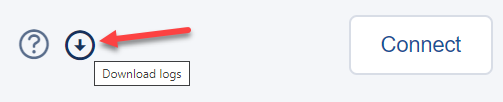

From the Login Screen
In the event that a user cannot log in to InGenius or cannot access the Settings menu, a Download logs button is available from the login screen, as shown in the image below:
To download logs from the login screen:
- Select the Download logs button.
- An empty text box appears. Type a description of the issue in the text box.
- Select the Download Logs button to download the logs ZIP file to your computer.
