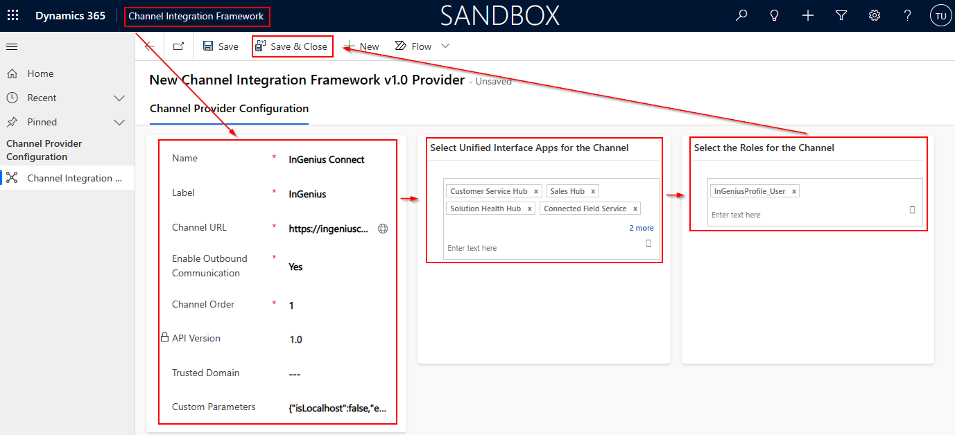

Configure Channel Integration Framework (CIF) V1
First, consult the Microsoft Dynamics documentation on how to configure CIF here.
While following the steps outlined in the link, ensure to input the following data:
- Name: InGenius
- Label: InGenius
- Channel URL: The URL of your org up until .com. After .com, copy and paste: /WebResources/ingenius_/tunnel/index.html. An example of a complete Channel URL is: "https://<Your-Org-URL>/WebResources/ingenius_/tunnel/index.html"
- Enable Outbound Communication: Yes
- Channel Order: 1
- API Version: 1.0
- Add apps under Unified Interface Apps for the Channel. Ensure not to add all apps at once, as there is a known issue in Microsoft Dynamics when adding all apps at the same time.
- Under Select the Role for the Channel, select the InGenius security role you created earlier. (InGeniusProfile_User)
- Custom Parameters: Input in
{"isLocalhost":false,"region":"<YourRegion>"}
Note: <YourRegion> is determined by your deployment region for InGenius (e.g 'ca-central-1', 'us-west-2', 'eu-est-1', or 'ap-southeast-2', as detailed here.)
Select Save & Close to complete the configuration.

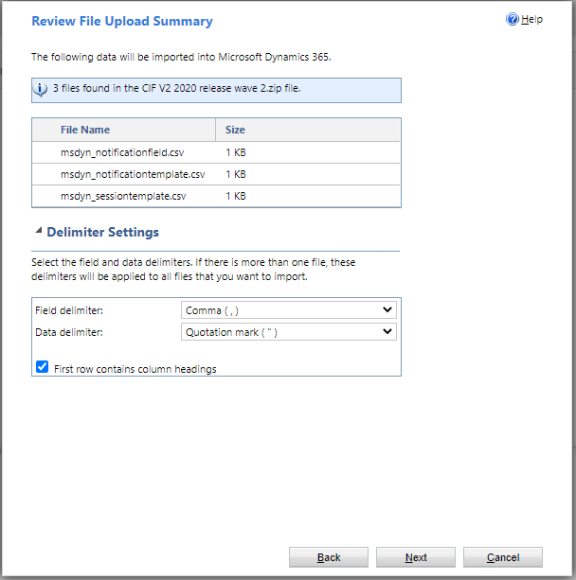

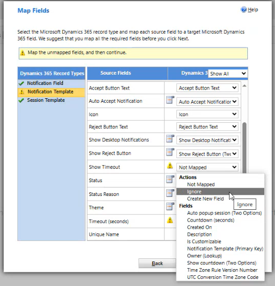

Ensure Files and Delimeter Settings are the same as in the image below, then select Next.
Under System Data Maps, select Default (Automatic Mapping), then select Next.
Note: If the Notification Template record type displays a warning, check to see if the "Show Timeout" and "Timeout (Seconds)" fields are unmapped. These can be set to "Ignore".

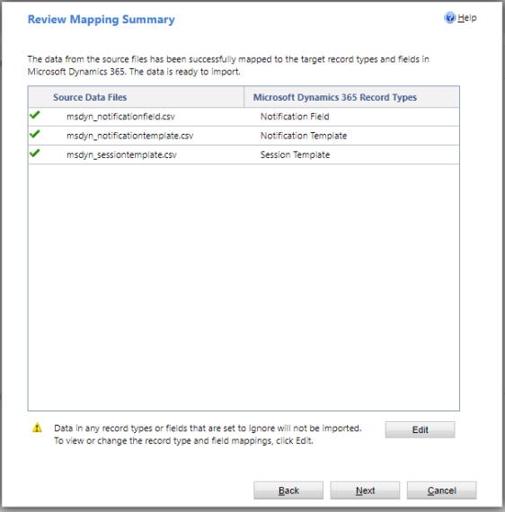

Ensure Source Data Files and Record Types are the same as in the image below, then select Next.
Ensure to select No under Allow Duplicates, then select Submit.

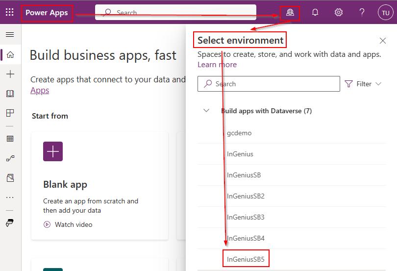

- Navigate to the Power Apps Page.
- On the top banner, click on the Environment tab and select your D365 environment which contains Customer Service Workspace.

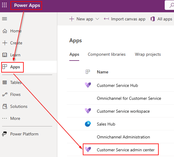

Navigate to the Apps section, select All, and open the Customer Service Admin Center app.

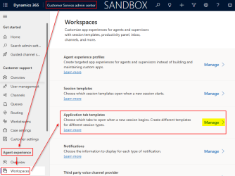

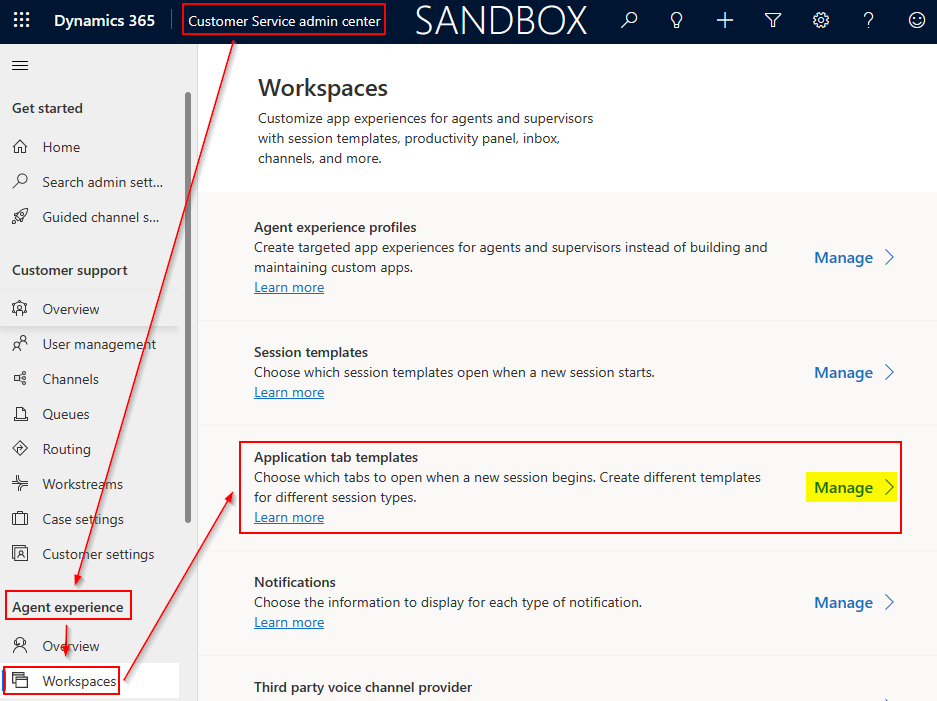

- In the Customer Service Admin Center, navigate to Agent Experience | Workspaces in the side menu, and then select Manage under the Application tab templates section.
From the top banner, click the New button to create a new Application tab template and fill in the following information:
Name - InGenius - Default Tab
Unique Name - ingenius_defaulttab
Note: The unique name field must match the above name exactly.
Title - InGenius
Page Type - Dashboard
Description - Empty
Can close - Yes
Click Save & Close on the top banner.

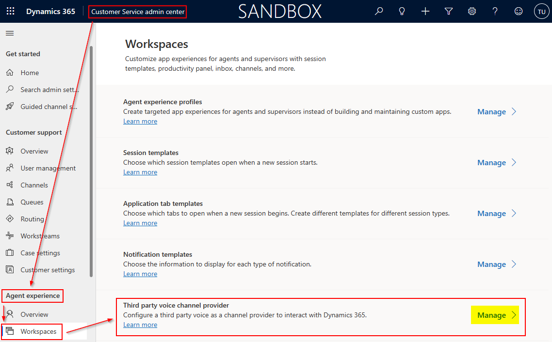

Configure Channel Provider
- In the Power Apps page, click on the Environment tab from the top banner and select your D365 environment which contains Customer Service Workspace.
Navigate to the Apps section, select All Apps, and open the Customer Service Admin Center app.
Navigate to Agent Experience | Workspaces from the side panel, and select the Manage under the Third party voice channel provider section.
Click New from the top menu bar to create a new Channel Provider, and fill out the required fields as follows:
Unique Name: ingenius_cif
Label: InGenius
Enable Out Bound: Yes
Channel Order: 1
API Version: 2
Trusted Domain: N/A
{"isLocalhost":false,"region":"<YourRegion>"}Note: <YourRegion> corresponds to your deployed InGenius region. (i.e ca-central-1, us-west-2, eu-west-1, or ap-southeast-2. Refer to Network Requirements for more information.)

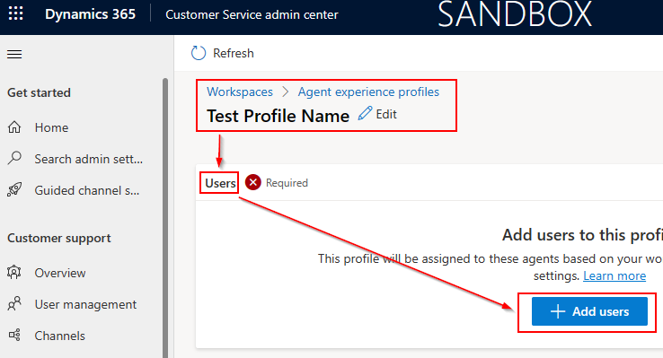

Configure Agent Experience Profile
After having configured the templates and fields, you will need to create and configure an Agent Experience profile to utilize them, and then add users to it.
Navigate to the Apps section and open the Customer Service Admin Center app.
Navigate to Agent Experience | Workspaces from the side panel and click the Manage button under Agent experience profiles.
Click the New button from the top menu to create a new Agent experience profile, and fill in the name fields without any spaces, then click Create to confirm.
Under the Agent experience profiles list, select the profile that was just created.
In the Users section, click the Add users button and use the search functionality to add desired users, then click Add.
