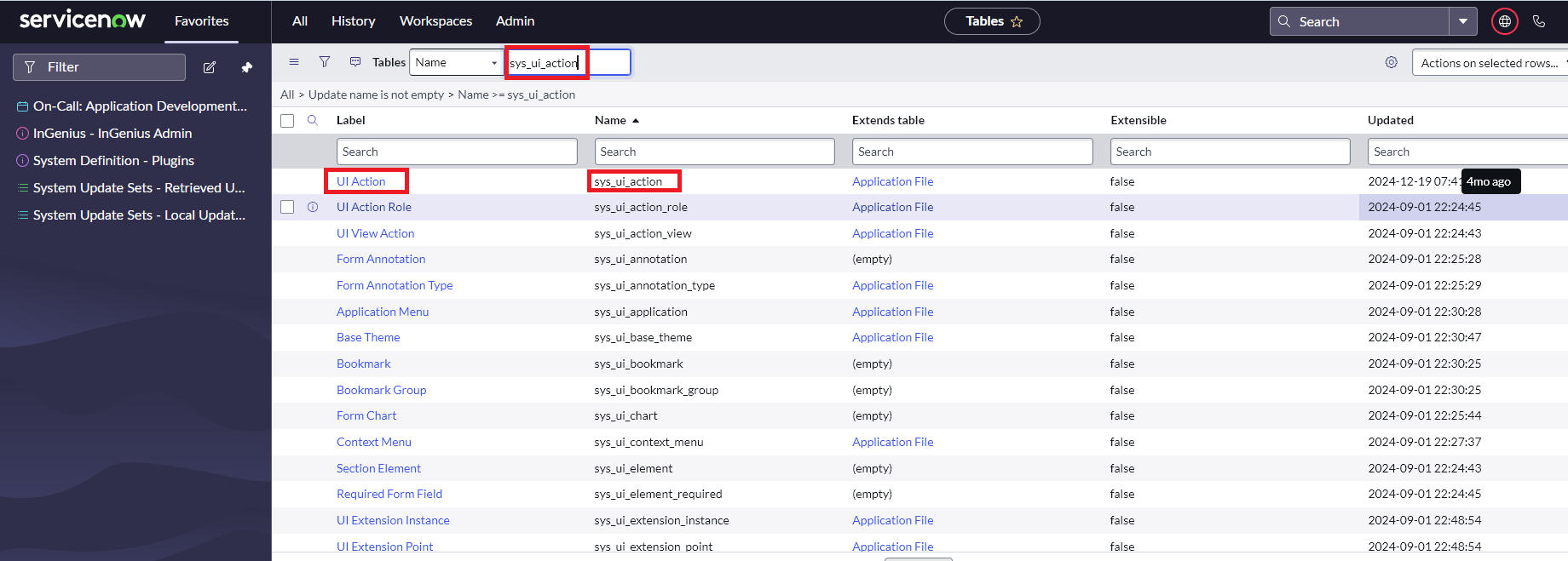

Login to your ServiceNow instance.
Navigate to All | System Definitions | Tables
Search for the 'sys_ui_action' table and select it.

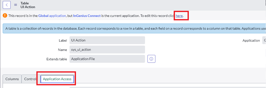

In the top ribbon, select the 'click here' link to edit the record, then select the Application Access tab.
Ensure that the 'Can create' and 'Can update' boxes are checked, then click the Update button at the bottom.
