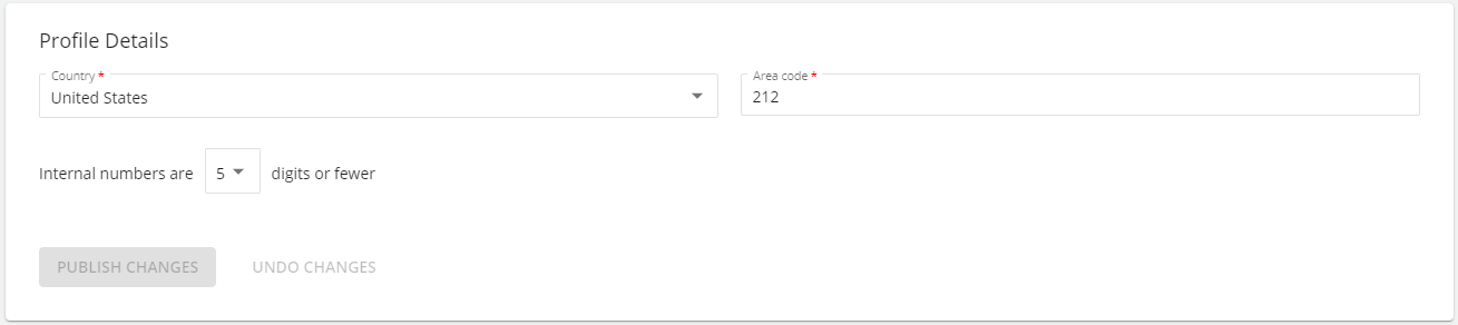

Country
Determine the country where users are calling/receiving calls in. Select the country from the dropdown list.
Area Code
Determine the area code used in your region. For instance, if your organization has a call center based in a location that uses the 212 area code, type 212 in the field.
Internal Numbers
Determine the length of internal numbers used within your organization. For instance, if internal numbers are five digits, select 5 from the dropdown list to ensure internal numbers are recognized and dialed correctly in InGenius.
