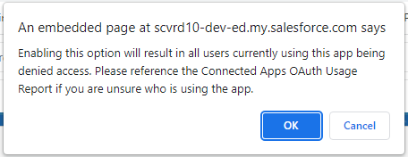

Under "OAuth Policies", change Permitted Users to "Admin approved users are pre-authorized"
Note: If you encounter the following pop up warning, click OK to continue.

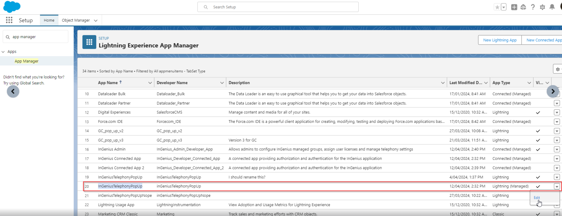

From Setup, enter App Manager into the Quick Find Box.
Select the App Manager from the list of options.
Find the "InGeniusTelephonyPopUp" app in the list, click the dropdown arrow, and select Edit.

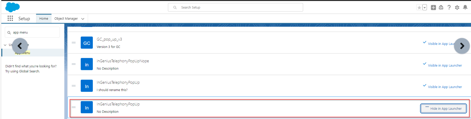

Return to the Quick Find box and enter App Menu, select it from the list of options.
From the list of available apps, find InGeniusTelephonyPopUp and select 'Hide in App Launcher'.
