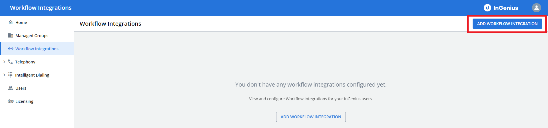

  1. In the Admin App, navigate to the Workflow Integrations page.
  2. Click the 'Add Workflow Integration' button on the top right corner of the page.

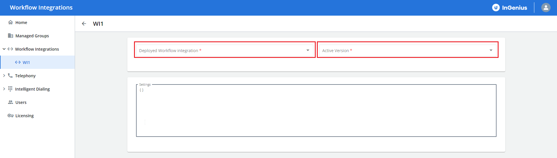

  4. In the profile page for the Workflow Integration you have created, select a Deployed Workflow Integration and an Active Version from the dropdown boxes.
    Note: If you cannot find a deployed workflow integration or active version, contact an InGenius specialist for help in configuration and deployment.
  5. Modify the values in the Settings field with your desired configuration.
    Note: The Settings field will automatically be populated when creating a new Workflow Integration and selecting a version.
