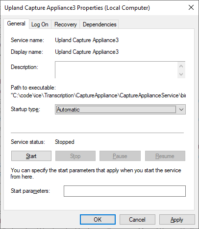

  3. In your Windows search bar, search for and click on Services.
  4. Right-click on the service named 'Upland Capture Appliance' to open its properties window
  5. Under the General tab, set the 'Startup type' dropdown to Automatic.

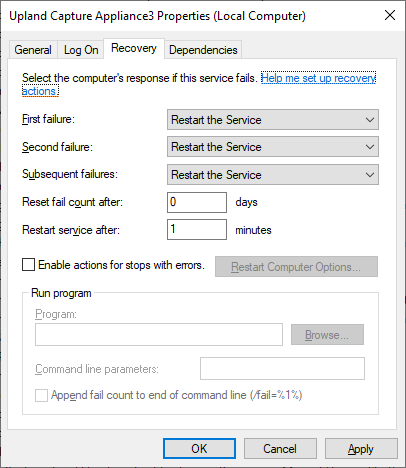

  6. Under the Recovery tab, configure the service to restart 1 minute after failure, then press OK.
