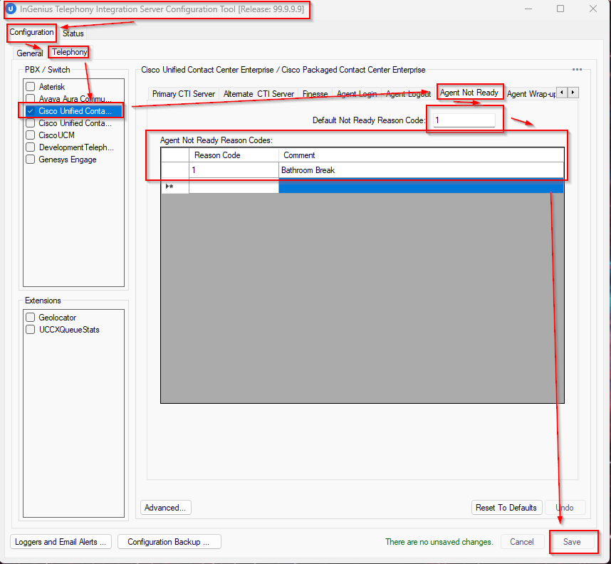

Work Mode on Incoming
If the Agent Desk settings have been configured with the attribute Work mode on incoming set to Required with Wrapup Data, the InGenius Telephony Integration Server Configuration Tool must be configured with an Agent Not Ready Reason Code default set as demonstrated in the steps below:
Open the Configuration Tool.
Navigate to the Configuration |Telephony tab.
- In the PBX/Switch section, select UCCE.
- Select the Agent not Ready tab.
- For the Default Not Ready Reason Code textbox, input a value of 1.
- For the Agent Not Ready Reason Code Table -
- Input a Reason Code value which is numerical, such as 1
- Input a Comment value which is alpha-numerical, such as 'Bathroom Break'
- Click the Save button located in the bottom-right corner.
