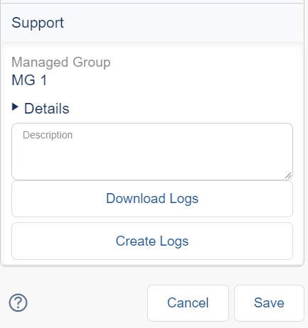

From the Settings Menu
Users can download their logs from within the InGenius UI, as shown in the image below:
To download user logs from the Settings menu:
- Select Settings in the InGenius application.
- Select the Support tab.
- Select the Create Logs button. An empty text box appears.
- Type a description of the issue in the text box.
- Select the Download Logs button to download the logs ZIP file to your computer.

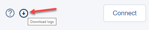

From the Login Screen
In the event that a user cannot log in to InGenius or cannot access the Settings menu, a Download logs button is available from the login screen, as shown in the image below:
To download logs from the login screen:
- Select the Download logs button.
- An empty text box appears. Type a description of the issue in the text box.
