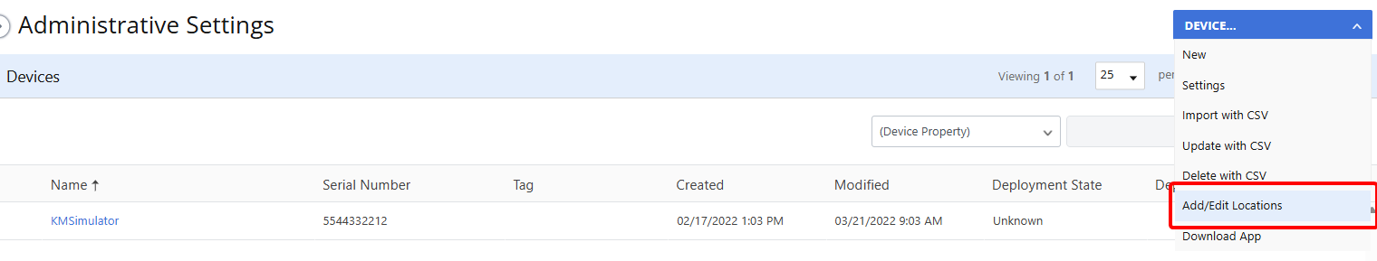

  1. On the Navigation Menu, click Settings, then click Devices.
  2. Click Device..., then select Add/Edit Locations from the drop-down menu.
  3. Click Add Location.
  4. In the Location Name field, enter a name to describe the location, then click Add.

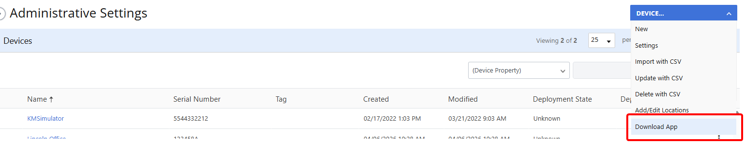

  2. Click Device..., then select Download App from the drop-down menu.
  3. From the Location drop-down list, select the location where you are installing the service, then click Download.
  4. In the Save As dialog box, navigate to the location where you want the application to be saved, then click Save.

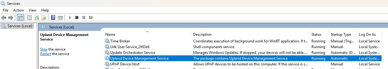

  10. Verify that the service is running in Windows Services.

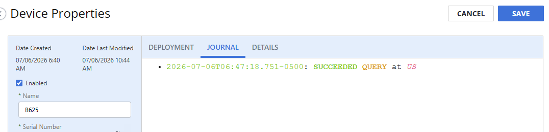

View journal
The journal provides a history of activities for the device.
  1. Perform one of the following:
    • Right-click anywhere in the device row or click the three dots next to the device you want to view the journal for, then select Properties from the drop-down menu.
    • Or, click the name of the device you want to view the journal for.
  2. Click the Journal tab.

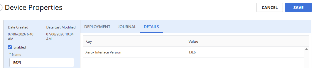

Query device
Running a query against the Xerox device returns the Xerox interface version. The Details tab in Device Properties is updated with this information.
  1. Right-click anywhere in the device row or click the three dots next to the device you want to query, then select Query Device from the drop-down menu.
  2. Perform one of the following:
    • Right-click anywhere in the device row or click the three dots next to the device you want to view query results for, then select Properties from the drop-down menu.
    • Or, click the name of the device you want to view query results for.
  3. Click the Details tab.

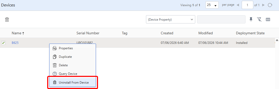

Uninstall from device
  1. Right-click anywhere in the device row or click the three dots next to the device you want to uninstall from, then select Uninstall From Device from the drop-down menu.
