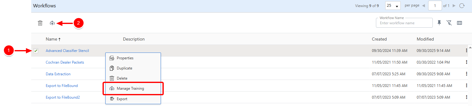

  1. On the Navigation Menu, click Settings, then click Workflows.
  2. Perform one of the following:
    • Right-click anywhere in the workflow row or click the three dots next to the workflow you want to access training for, then select Manage Training from the drop-down menu.
    • Or, select the check box next to a workflow, then click Manage Training.

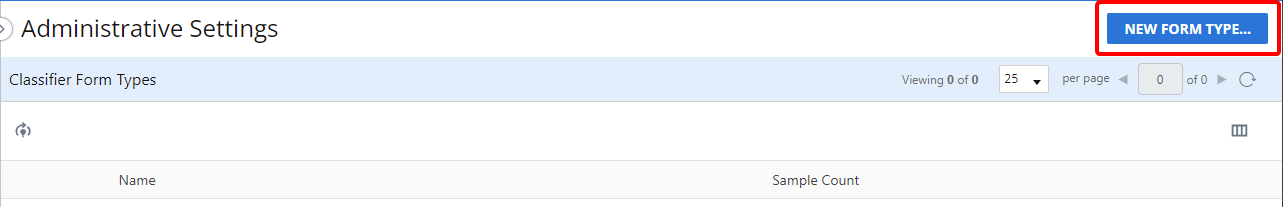

  2. Click New Form Type.
