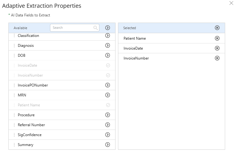

Configuration
  1. To access stencil properties, double-click an Adaptive Extraction stencil. Or, right-click an Adaptive Extraction stencil and select Properties.
  2. Click Add (>) next to the data field(s) you want to extract from the document. Or, move data fields from the Available box to the Selected box using a drag-and-drop operation.
    To remove a data field, click Remove (X) next to the data field in the Selected box.
  3. Click Save.
