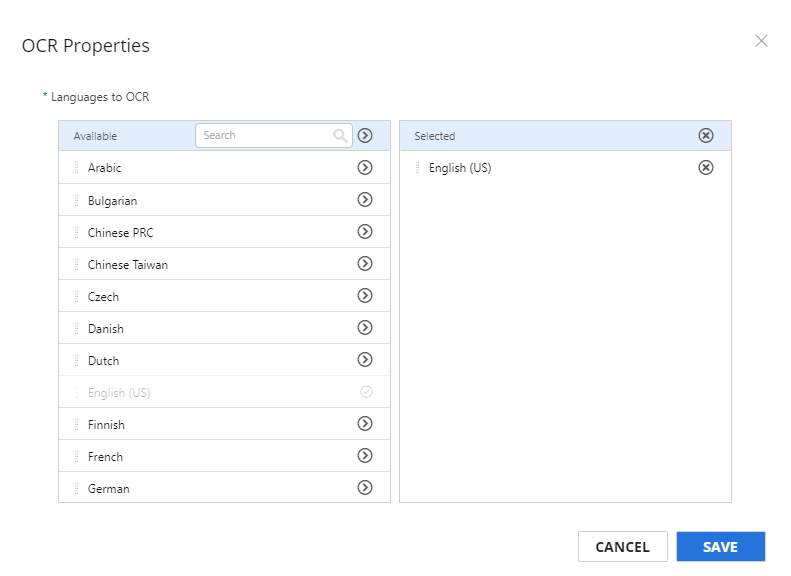

You can select specific languages to look for in the OCR step. English (US) is selected by default.
Tip: Selecting many languages at once will likely degrade the OCR quality and some languages cannot be mixed in order to avoid poor OCR quality. Select a minimal set of languages for best results.
  1. To access stencil properties, double-click an OCR stencil. Or, right-click an OCR stencil and select Properties.
  2. Click Add (>) next to the language(s) you want the stencil to look for. Or, move languages from the Available box to the Selected box using a drag-and-drop operation.
    To remove a language, click Remove (X) next to the language in the Selected box.
  3. Click Save.
