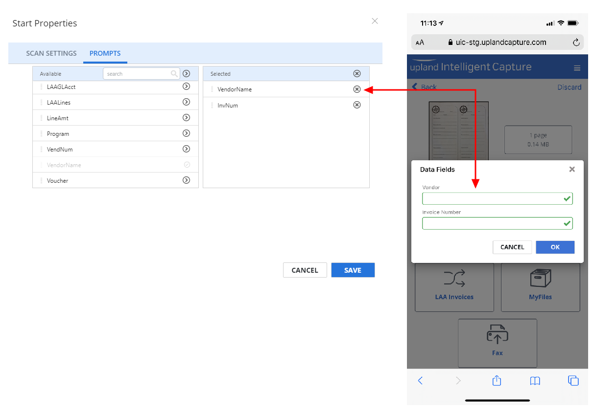

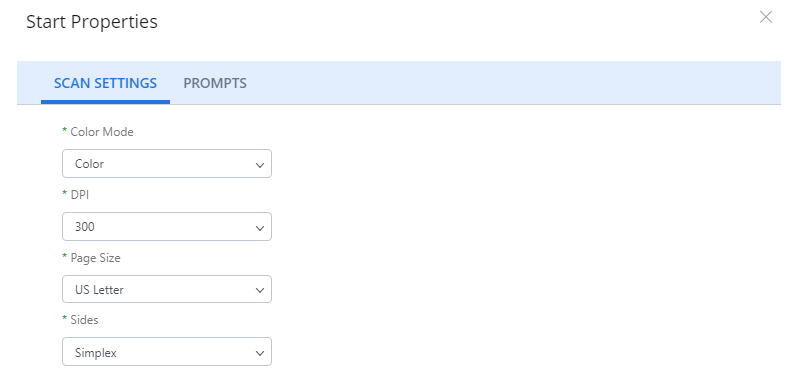

You can set the default scan settings for a workflow process in the properties of a Start stencil. You can also select which data fields are available for document indexing in Mobile Capture or when a document is submitted to a workflow from MyFiles, Work Items, or an integrated application.

Click Add next to the data field(s) you want to add to the workflow. Or, move data fields from the Available box to the Selected box using a drag-and-drop operation.
To remove data fields from the workflow, click Remove All or click Remove next to specific data fields in the Selected box.

These are the default scan settings for the workflow process.
Color Mode: Documents scanned into this workflow process will be in this color by default. The following options are available:
DPI: Documents scanned into this workflow process will be in this resolution by default.
Page Size: Documents scanned into this workflow process will be in this page size by default. The following options are available:
Sides: Documents scanned into this workflow process will be scanned like this by default. The following options are available:
The data fields selected will appear in Mobile Capture for document indexing or when a document is submitted to a workflow from MyFiles, Work Items, or an integrated application.
