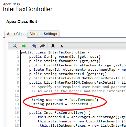

  5. Click “New”, copy and paste in the contents of ‘InterFaxController.txt’, and save.
  6. Edit the “InterFaxController” Class which was created, and insert your InterFAX Credentials.

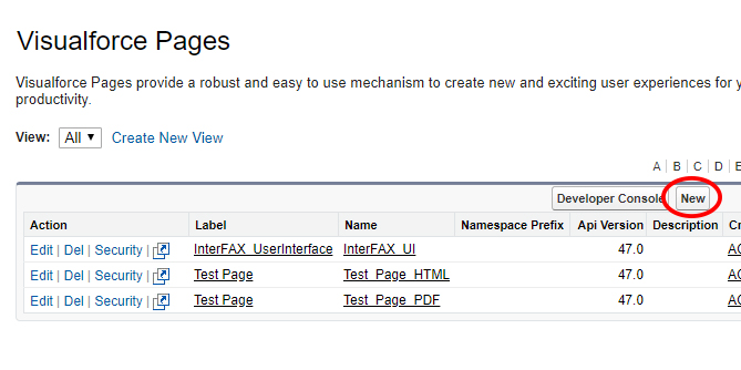

  7. Navigate to: Build > Develop > Visualforce Pages,
  8. Click “New”, paste in the contents of UI.txt, and save (Be sure to note the name you give to the page, e.g. “InterFAX_UI” in the following steps).

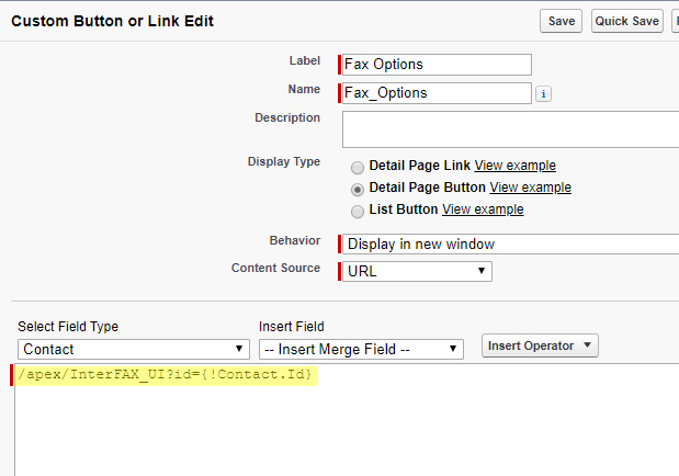

  9. Now to choose which record to add our Button to (e.g. Contact), navigate to: Build > Customize > (Chosen Object) > Buttons, Links and Actions.
  10. Click “New Button or Link”.
  11. Paying attention to the highlighted section, create your button by using the name of the page you created earlier (e.g. “InterFAX_UI” as created in Step 9.) and save.

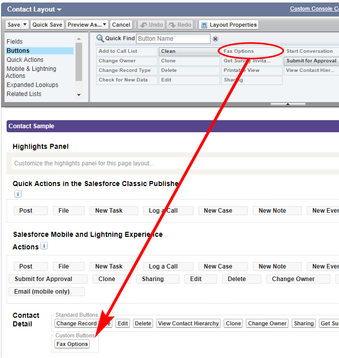

  12. Navigate to: Build > Customize > (Chosen Object) > Page Layouts.
  13. Click Edit for the desired Page.
  14. Under Contact Layout, select Buttons from the left-hand side, and then drag-and-drop the Button (e.g. Fax Options), created in step 12, to the appropriate section (as seen below), and save.

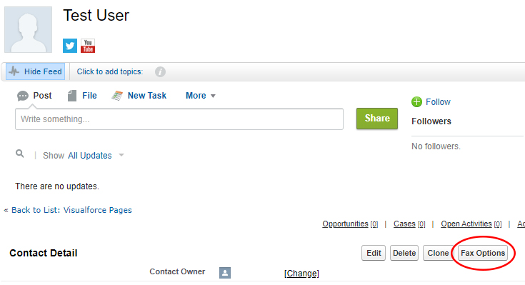

  15. Afterwards, you should see the button you created under records associated with that object (example below).

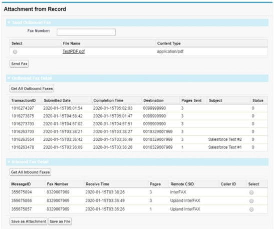

  16. Once clicked, will take you to the following page that will allow you to fax attachments associated with the object.
  17. To receive and save inbound faxes, each user will stay on the screen from step 16, press the “Get All Inbound Faxes” link, choose the fax they would like to save, click “save”, and the fax will be stored in that user’s attachments.
