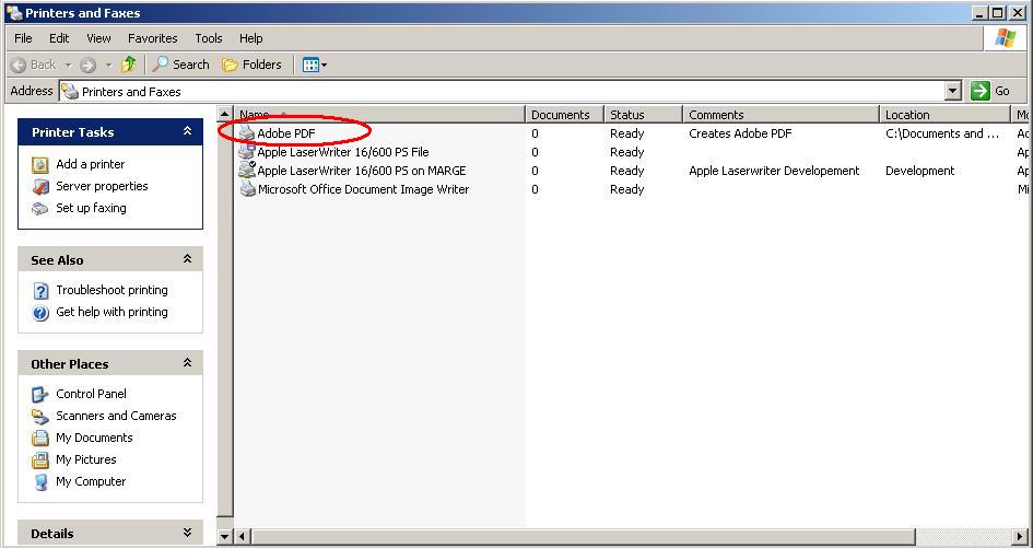

Go to Start->Printers and Faxes on your system.
Select the Adobe PDF driver and go to its properties

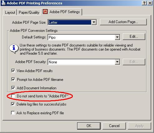

Select the Printing Preferences button.
Uncheck the Do not send fonts to Distiller option and press OK.
