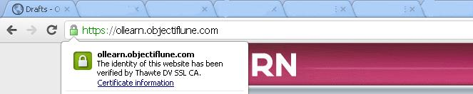

    • Google Chrome:

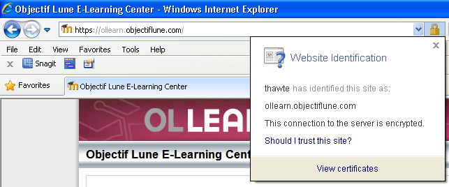

    • Internet Explorer 8:

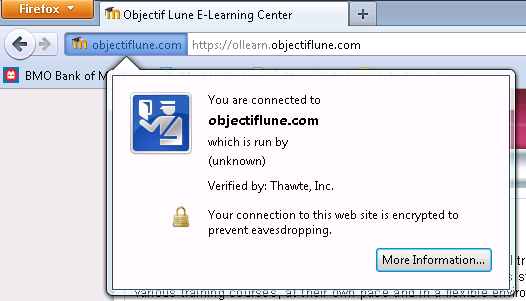

    • Mozilla Firefox 7:
