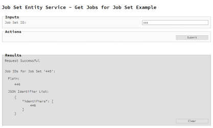

Screenshot & Output
Usage
To run the example simply enter the Job Set ID and select the Submit button to request a list of the all the jobs contained within the specific job set in the server.
The resulting list will then be returned and displayed to the Results area in both Plain list and JSON Identifier List formats.
