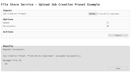

Screenshot & Output

To run the example simply select the Browse button and then select the job creation preset you wish to upload using the selection dialog box.
Next you can specify the following options to use with the upload of the job creation preset:
  • Named – allow this preset to be identified/referenced by its Managed File Name as well as its Managed File ID
  • Persistent – make this preset persistent in the file store
Note: Only one Managed File in the file store can be associated with a specific name. If two files are uploaded to the file store under the same name, then only the most recently uploaded file will be associated with (or can be referenced using) that name.
Once the preset and options are selected, simply select the Submit button to upload the preset to the server's file store and the resulting Managed File ID for the job creation preset will be returned and displayed to the Results area.
