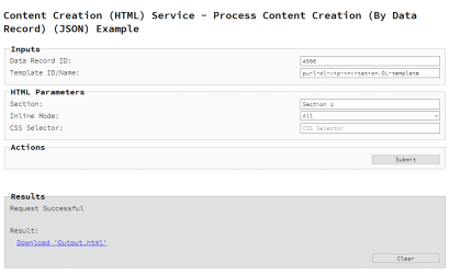

Screenshot & Output

To run the example you first need to enter your Data Record ID and the Template Managed File ID/Name (previously uploaded to the file store) into the appropriate text fields as your inputs.
Next you can specify the HTML parameters to use when creating the web content:
  • Section – the section within the Web context of the template to use
  • Inline Mode – the inline mode to be used in the creation of content
  • CSS Selector – a CSS selector for the creation of only a specific HTML element within the template
Lastly, select the Submit button to create and retrieve the web content. When the response returns a Result Link will be displayed in the Results area. This link can be selected to view the resulting web content that was created.
