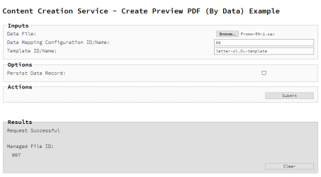

Screenshot & Output
Usage
To run the example you first need to use the Browse button to select an appropriate Data File to use as an input using the selection dialog box.
Next, you need to enter the Managed File ID or Name of both your data mapping configuration and template (previously uploaded to the file store) into the appropriate text fields.
Lastly, you can specify the following option to use when creating the preview PDF:
Persist Data Records – Create/persist data record entity in the server during the content creation process (intended for use with once-off jobs where the storage of the data record in the server is not required).
Once done, select the Submit button to create the preview PDF. When the response returns, a Managed File ID of the preview PDF (in the file store) will be displayed in the Results area.
